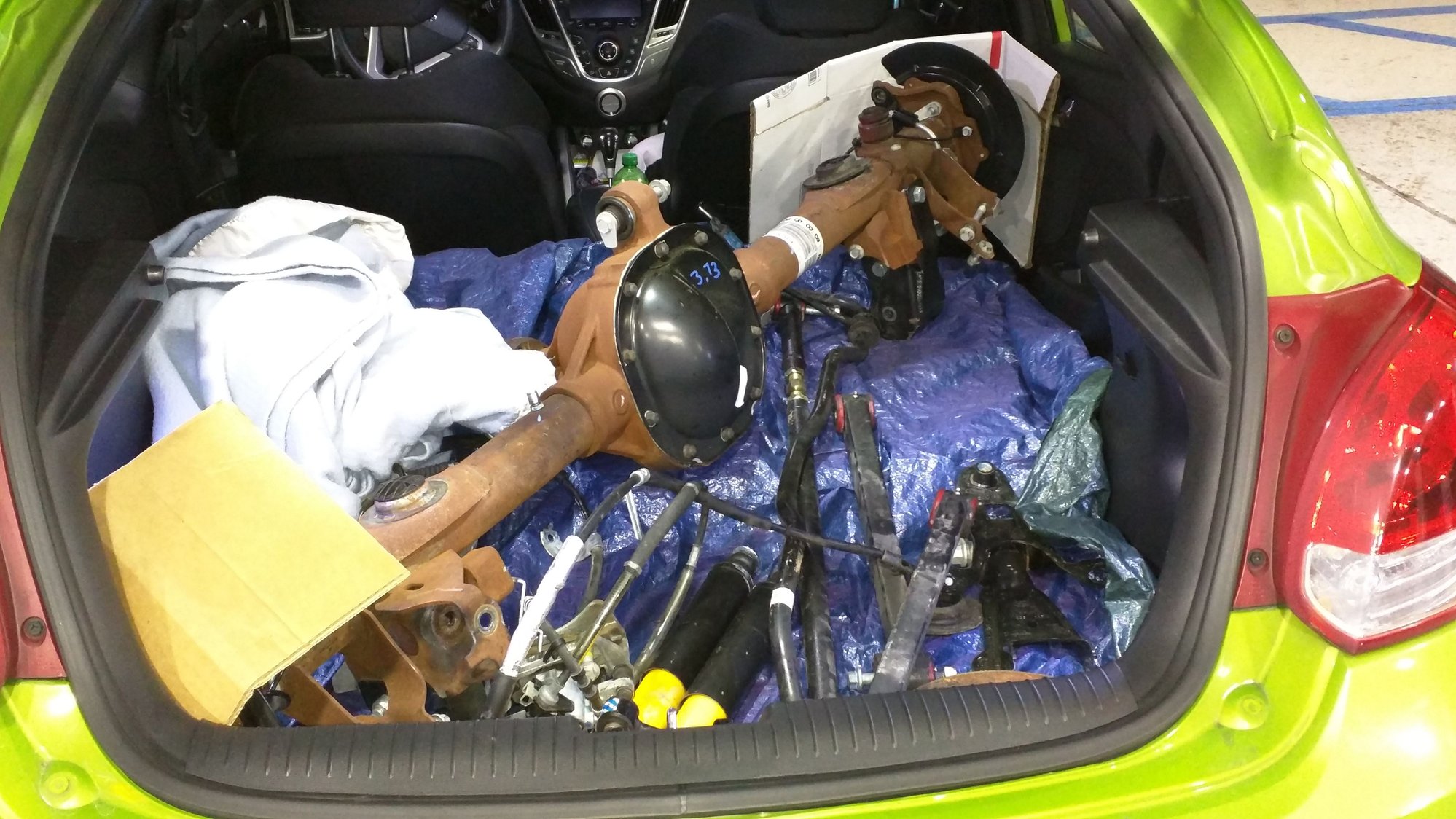

this is where I got my 8.8 rear end, they were reasonable and I drove there to pick it up, not sure where in florida you live but is might be a consideration instead of paying shipping costs.
odd the link is not showing up, go to facebook and search "The Parts Farm"
also http://stores.ebay.com/thepartsfarm
