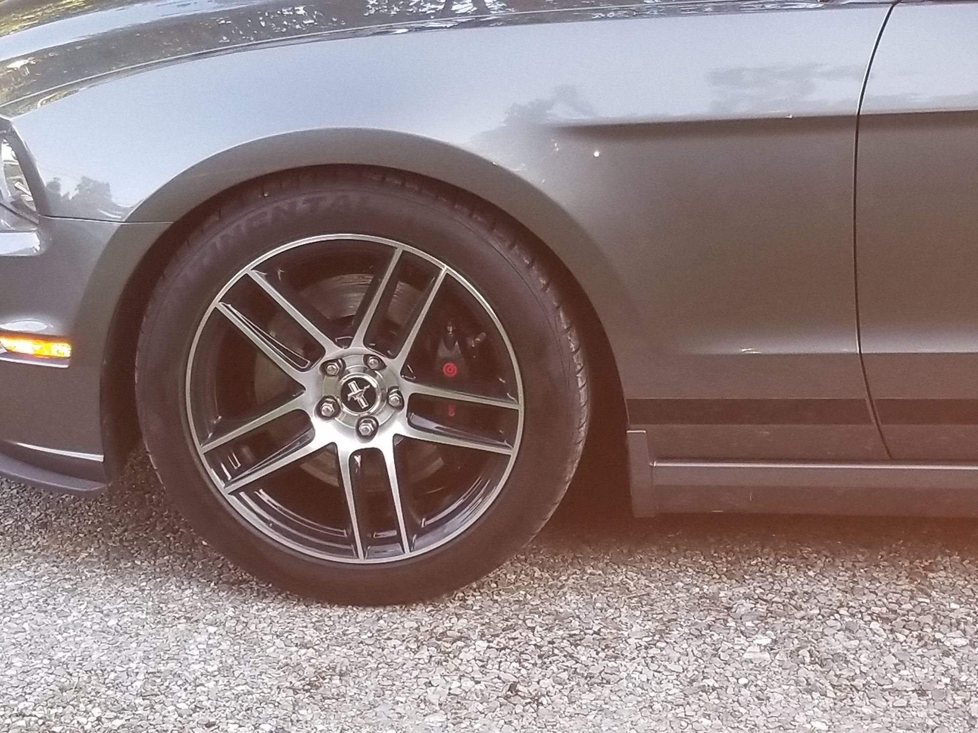

I'm fairly ignorant about, well most things , but on this topic. Wheel fitment. I know the s197's have 5x4.50 bolt pattern so I'm curious if one of you guru's on here can explain why these: https://www.performanceplustire.com/...MaAqQlEALw_wcB wont fit. Is the center hole too small? big? Wrong back spacing for the brakes to clear? I'd love to put a set on my 2008.

You need a 16 inch wheel to clear the brakes and the offset is way off, the wheel lip will be 1.7 inches further out Than my 19X9 42 offset on the front of my 2013 which would put the wheel about 1.5 inches outside my fender.
