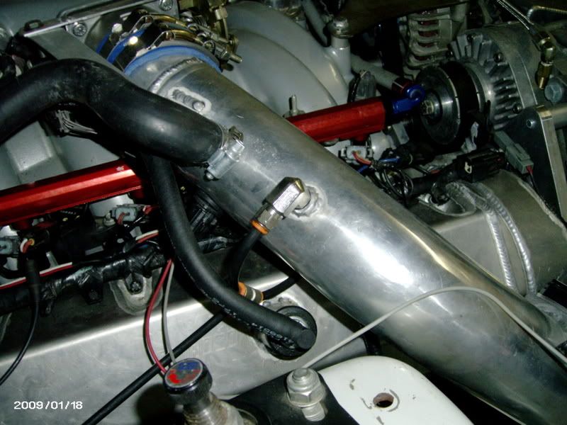

These 2 wires are the IAT
you spray your meth kit after the IAT?

No that pic was taken during the build. The IAT is after the meth.
ah, that makes sense.
You have it in the manifold?

No you can see it in the pic right below the IAC and after the meth.

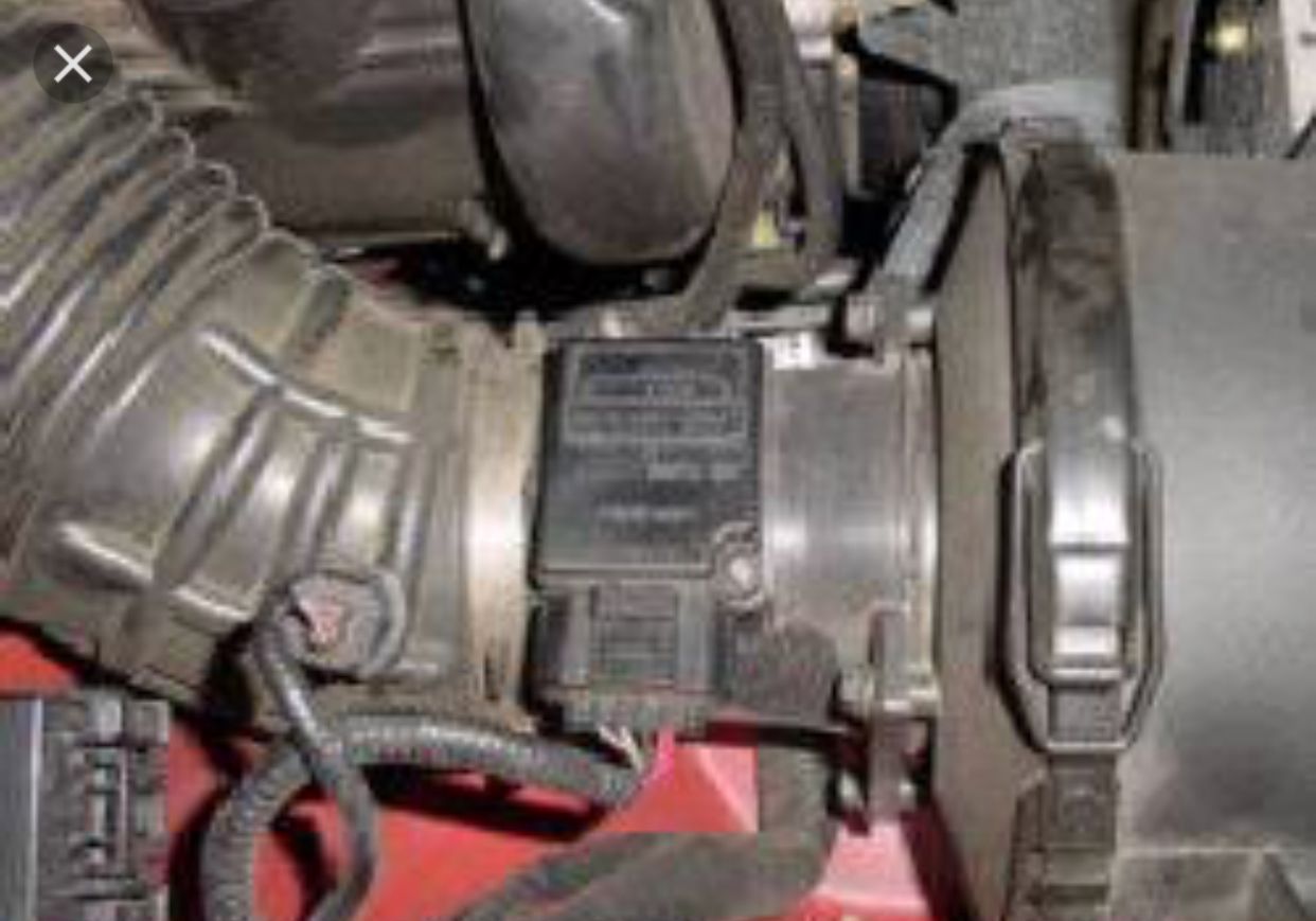

Does the IAT sensor plug into the MAF? I am getting the P113 as well. Do you have to clean or replace the MAF or is the IAT replaceable somehow on the MAF?
Depends on the year. Some early year cars have separate iat sensors in the intake tube a few inches up from the maf. If you don’t have any sensors on the intake tube other than the maf and you’re 100% sure there aren’t. Then it’s built in to the maf.

OK, so I do not have a separate IAT so if I am getting a P0113 I should diagnose/clean/replace the MAF or wiring harness? The IAT is not a component of the MAF that can be replaced correct?
correct
