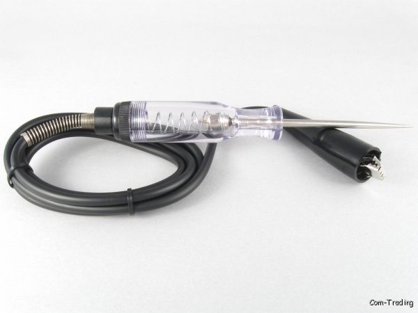

You will need one of these:
You "stab" the point into a wire and put the clamp on the body of your car. The light bulb will go on if you have power.
