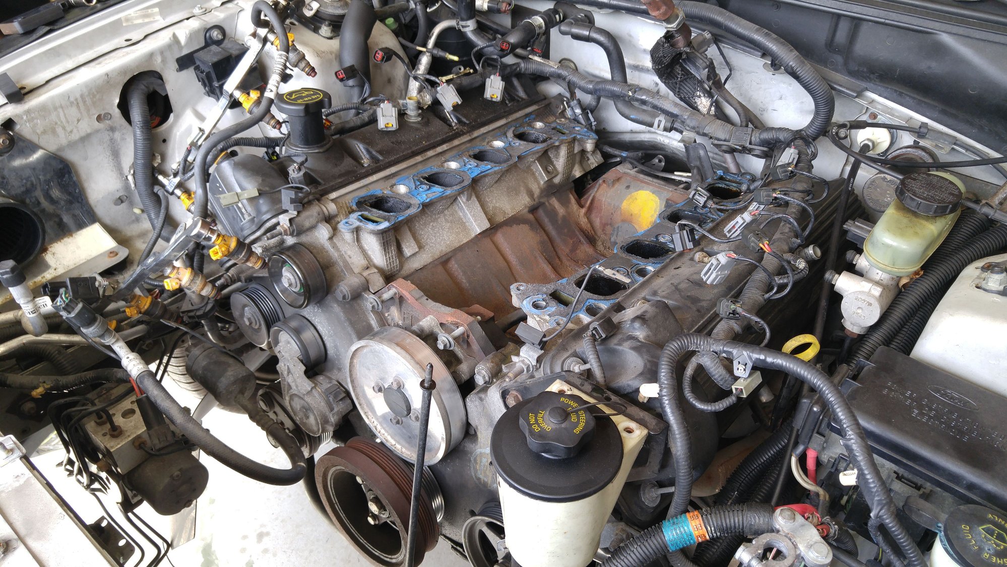

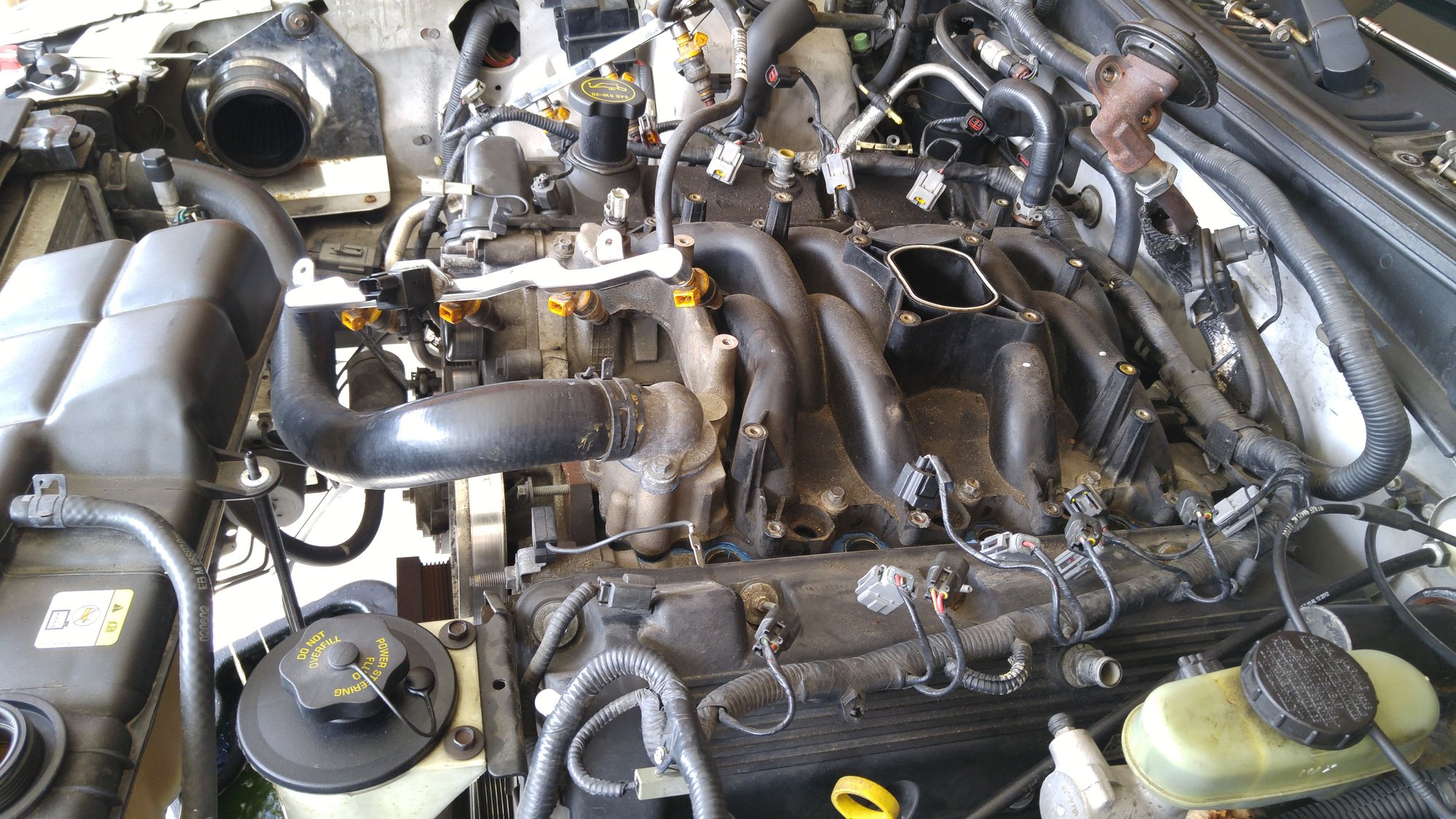

So today, my buddy (also my ex-brother in-law and I began tearing out the original engine. The 4.6 coming out is solid has 119k on it and runs great so before I screwed it up I figured it was best to pull it while it runs so I can sell it and recoup some of my build budget.
Some pics.
We had the engine torn down and loose from the car in about 2 hours, we would have had it out but my cherry picker jammed, so my buddy is getting his from his house and we'll have it out of the car and on craigslist by end of the day.

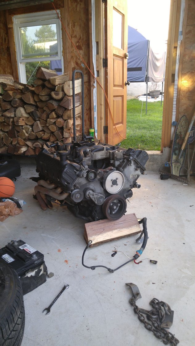

The original engine, sounded bad *** with the long tubes.

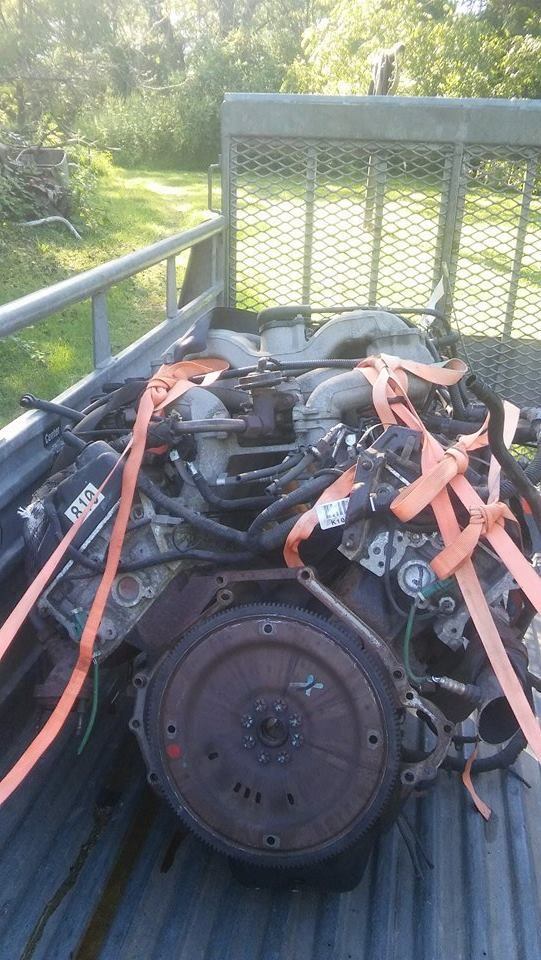

I was originally going to go with a long block remanufactured assembly, but opted to go with a Junk Yard engine with lower miles (80k) to try and test this out. If it works and we get it tuned and running right I will spring for a full long block next year.
So today, I got my engine.

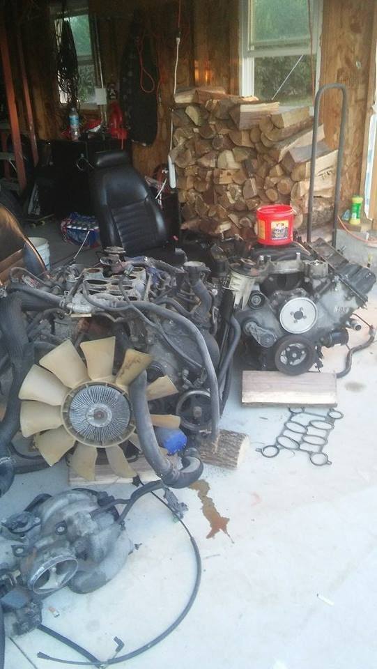

Wasting no time, got the engine in the garage and ripped that monstrosity of an intake off.
Tearing down the rest of the motor this weekend in order to clean it, re-gasket the valve covers and clean it up.
