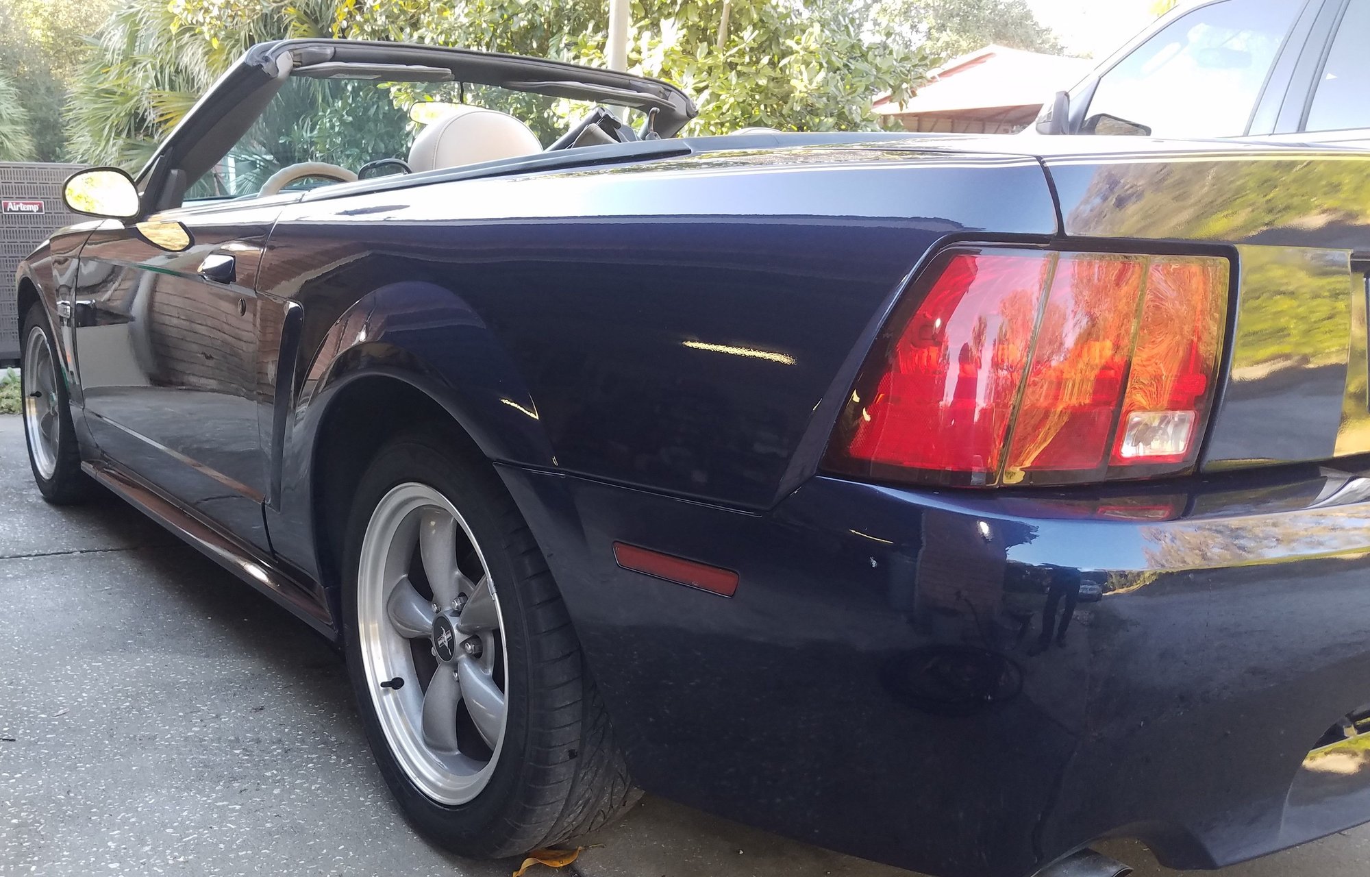

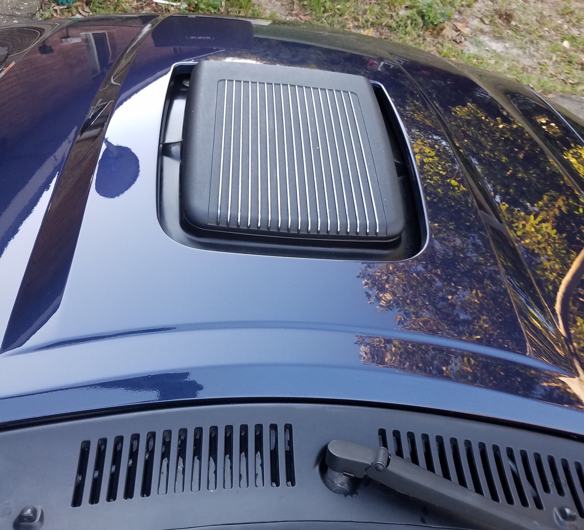

Ford didn't build one so I built it myself. I finally got my Frankenstein convertible back from paint and close to being finished so thought I'd share a few pictures of the fruits of my labor.
With the Mach I gadgetry it's a party up front and with the shaved deck lid and Bulllitt side scoop deletes it's business in the rear. An inverted mullet, if you will.

Nice indeed.Do those side scoop delete panels just snap into the old GT scoop body holes?

Yes those are factory Bullitt scoop deletes so they use the same mounting holes as the scoops. There is a guy on Ebay who makes repops that use double stick tape and from the reviews I read, they fit real well too and are a lot cheaper but I'm kind of a stickler for factory parts when I can be.
One of the toss ins that the paint shop did for me was to paint my grill delete and chin spoiler with a flex paint so I won't have to ArmorAll it all the time. I have 2 shaker setups so I had him paint my other one kind of a satin black to match the grill/spoiler and it looks pretty sweet so I have that one on there now. I like the silver stripes on the ribs but I'm afraid to mess with my freshly painted shaker.
I love the extra power and even having done a Mark VIII Intech swap prior, I still got an education doing this whole Mach 1ish project. For instance, this engine has an 8 bolt crank which means it was from a standard shift car so I believe that means that it is forged. Goody for me. But I didn't count on that and planned on using the Mark VIII 6 bolt plate. I beat my head against the wall for a week trying to find one and wasn't sure that there was even such a thing as an 8 bolt automatic flex plate. But lo and behold a call to MPS solved that problem. They knew right away what I needed and informed me that using the flex plate out of a 99/00 Cobra automatic is the winning combination. 30.00 plus 15.00 shipping and that was that.
