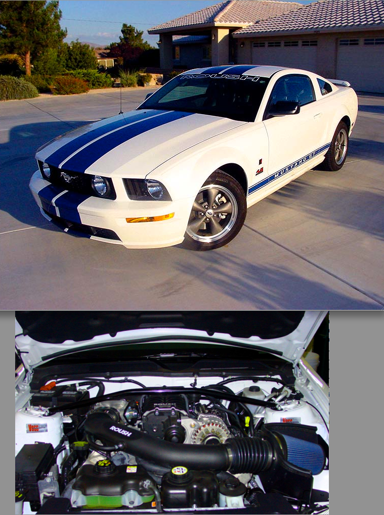

I really don't mean to be criticizing what mods you've done, but I assume you want an honest answer. Unless you have a lot of other mods on the car you can't live without, I would sell it & buy a really clean, low mileaged 4.6L & then put a Roush Supercharger on it! You'll be at 460 HP with that one single $7.5 to 8K modification! From my experience you would have loved my Mustang below! It makes a much nicer all around car than building the engine & will have much better resale because of the GT 500 approach to power. It sounds like you've invested quite a bit already, & someone out there may want all those mods & give you a reasonable price for it. From my personal experience it is the way to go! I don't know what your budget is, but a clean, low mileage 5.0L would be another way to go!
I'll be ordering a 2016 & putting a Roush Supercharger on it!
The Supercharged 4.6L below runs strong much like a 2015 5.0L! The Supercharged 4.6L has much less torque than the 5.0L but comes very strong from mid to high RPM. As far as enjoyable power I don't see a major difference between them.
Hope this helps! Old "D"
