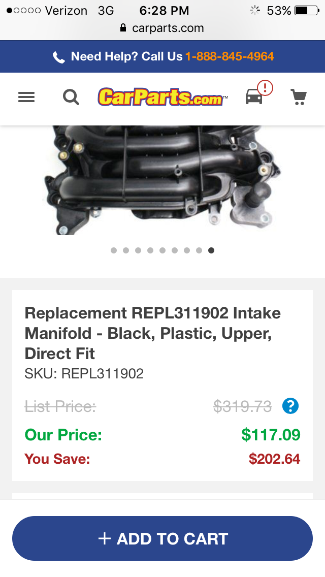

Haha 😂 damn neighbors... but I found what I need. Comes with alternator bracket, thermostat everything and it's on sale! Thanks so much guys! I'm new to this and y'all have been a great help! https://www.carparts.com/details/Ford/Mustang/Replacement/Intake_Manifold/1998/GT/REPL311902.html?TID=gglpla&origin=pla&gclid=EAIaIQ obChMIkdOP8If13AIVhpOzCh1pew98EAQYAiABEgILy_D_BwE& gclsrc=aw.ds
