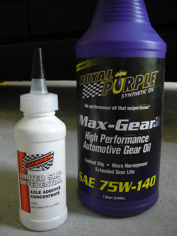

75W-140 High Performance Synthetic Rear Axle Oil
4oz. bottle of Additive Friction Modifier XL-3 (EST-M2C118-A)

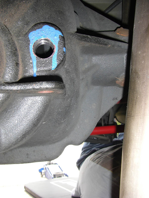

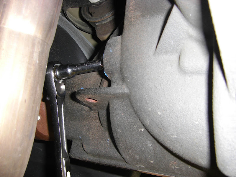

3. Using the 3/8" male socket extension, remove the fill plug from the front driver's side of the differential. As you loosen the plug you will hear air going inside the differential housing. Once you have removed the plug you will probably see small metal shaving attached to the back of it. The plug is actually magnetic to attract any metal debris and keep it from interrupting the gears movement.
4. Using a 1/2" ratcheting wrech, remove the majority of bolts on the differential cover while leaving the top bolt in place but loose.

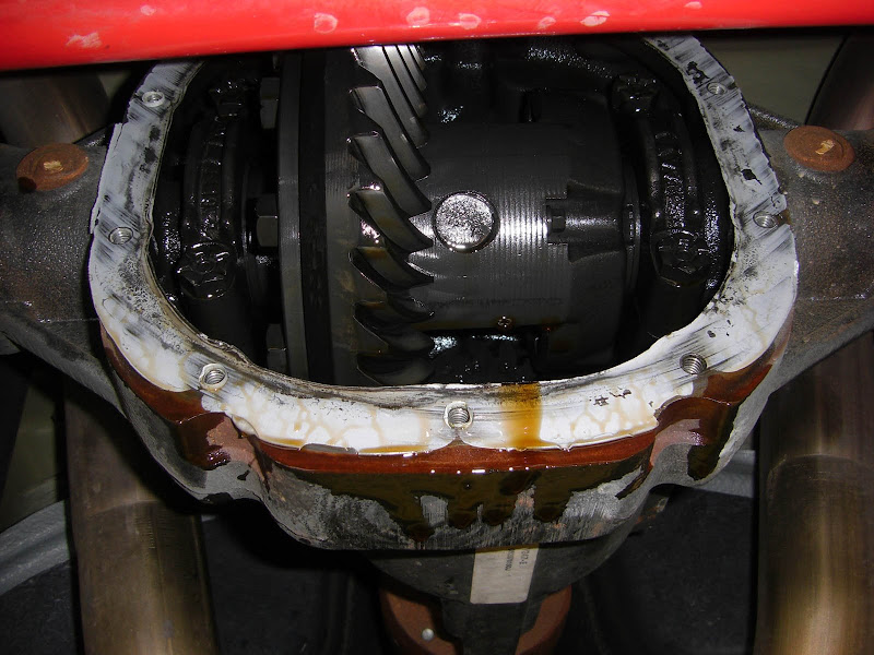

5. Pry the cover away from the mating surface with a flathead screwdriver carefully so not to bend the cover. The fluid should begin draining out into your drain pan below. Once the fluid is almost completely drained, you can remove the last bolt at the top holding the cover in place.
6. Remove the cover. (Tip: I found it easiest to working it up and to the passenger side of the car without removing the panhard bar .)
7. Use a lint-free rag to clean the inside of the cover and easily reached areas inside the differential housing.
(Note: This may be a good time to inspect the gears for any potential failure; chips, cracks...etc)
8. Scrape off the old mating gasket with a gasket scraper or putty knife making sure the surface is free of any old gasket material. After removing the old gasket, the mating surface should be clean and dry.

12. Fill the differential housing with a 4oz. bottle of Additive Friction Modifier (I used Champion Axle Additive Concentrate) and fill the rest with High Performance Synthetic 75W-140 Gear Oil (I used Royal Purple Max-Gear) until the fluid is level with the bottom of the fill hole.
