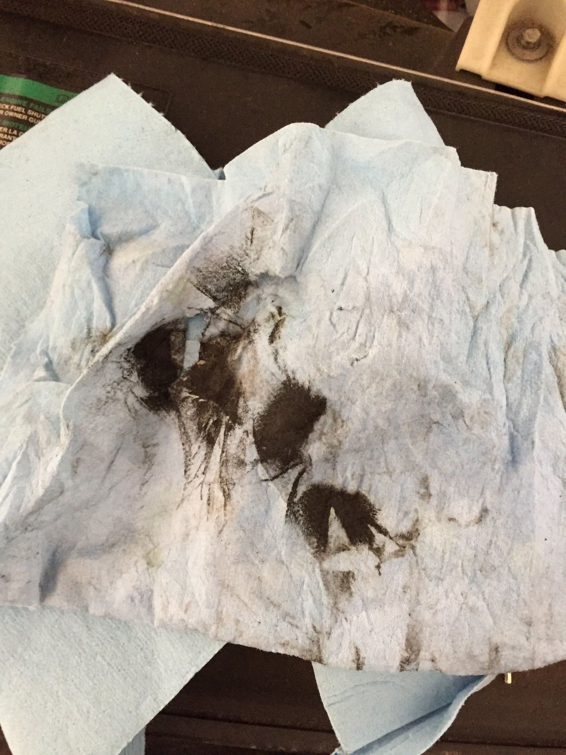

I got in there Friday and cleaned the CAI filter, the MAF, and the throttle body. It was all pretty dirty. Still waiting to see if this solved the problem, I haven't gotten to drive my car much the past couple of days. ��
A before shot of the CAI filter, nasty
Just some of the gunk that came out of my throttle body
The cleaned off filter, not completely like-new, but much better. Just hope I didn't over do it with the filter oil
