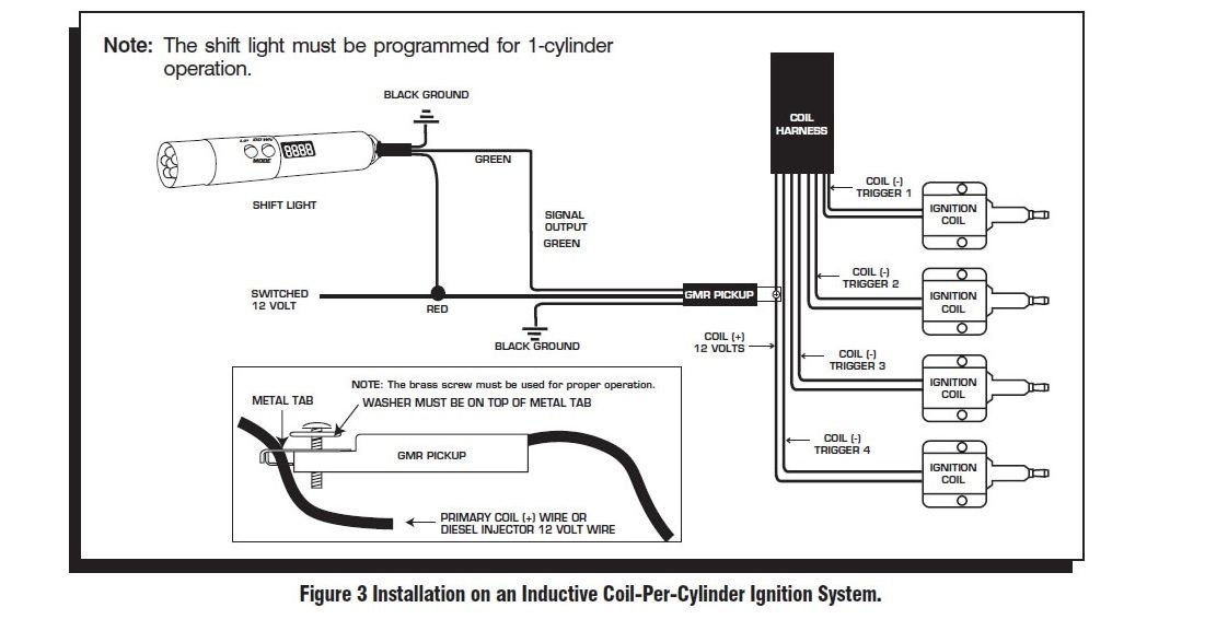

want to install an rpm shift light on my 2006 GT, any clue where I find the wire for the tach pick up?

there is no tach pickup, most shift lights have to be set to 1cyl mode and be tapped into the ground side of one of the coil packs
msd pic shown, may vary

I hooked mine up to one of the injector wires I believe.

FYI, if I remember correctly, an MSD Shift light needs a Tach adapter
but the Raptor Shift Light doesn't. .....i.e. Autometer Tach adaptor # 9117
