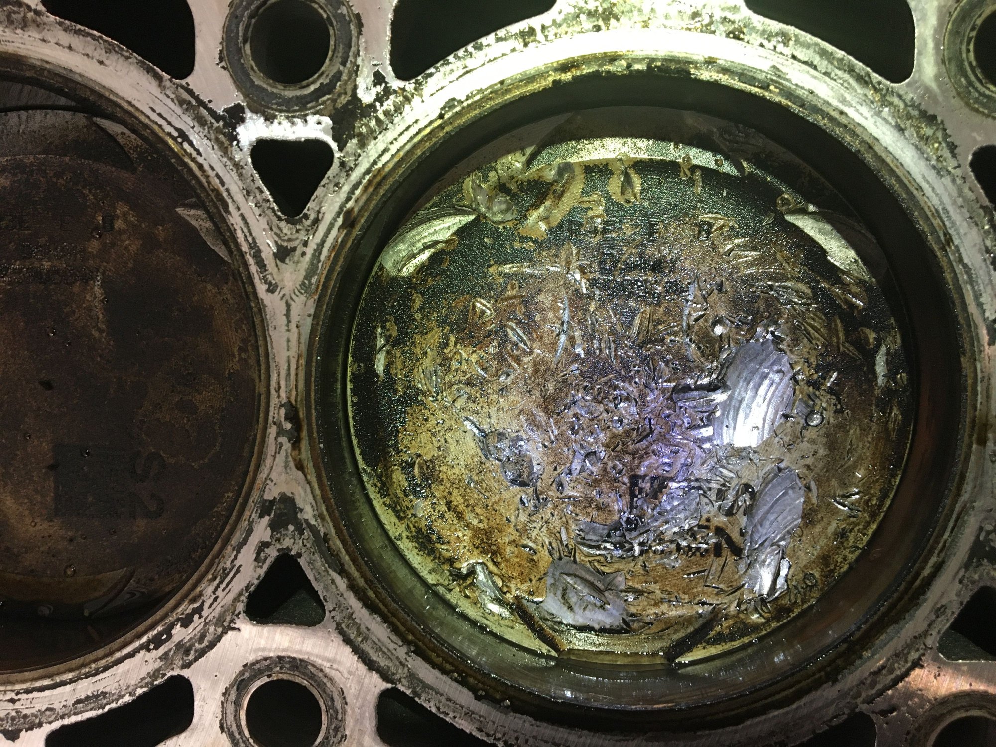

Aaaaannnnddddd its dead heard a knock so rebuilding during the lockdown.
now for the rebuild
Old Mar 28, 2020 | 01:57 PM
zkdawg's Avatar
zkdawg
Joined: Mar 2020
Posts: 36
From: nc
And this is what happens when the time goes off 180 deg. Another note, i cant seem to find the other piece of the valve
