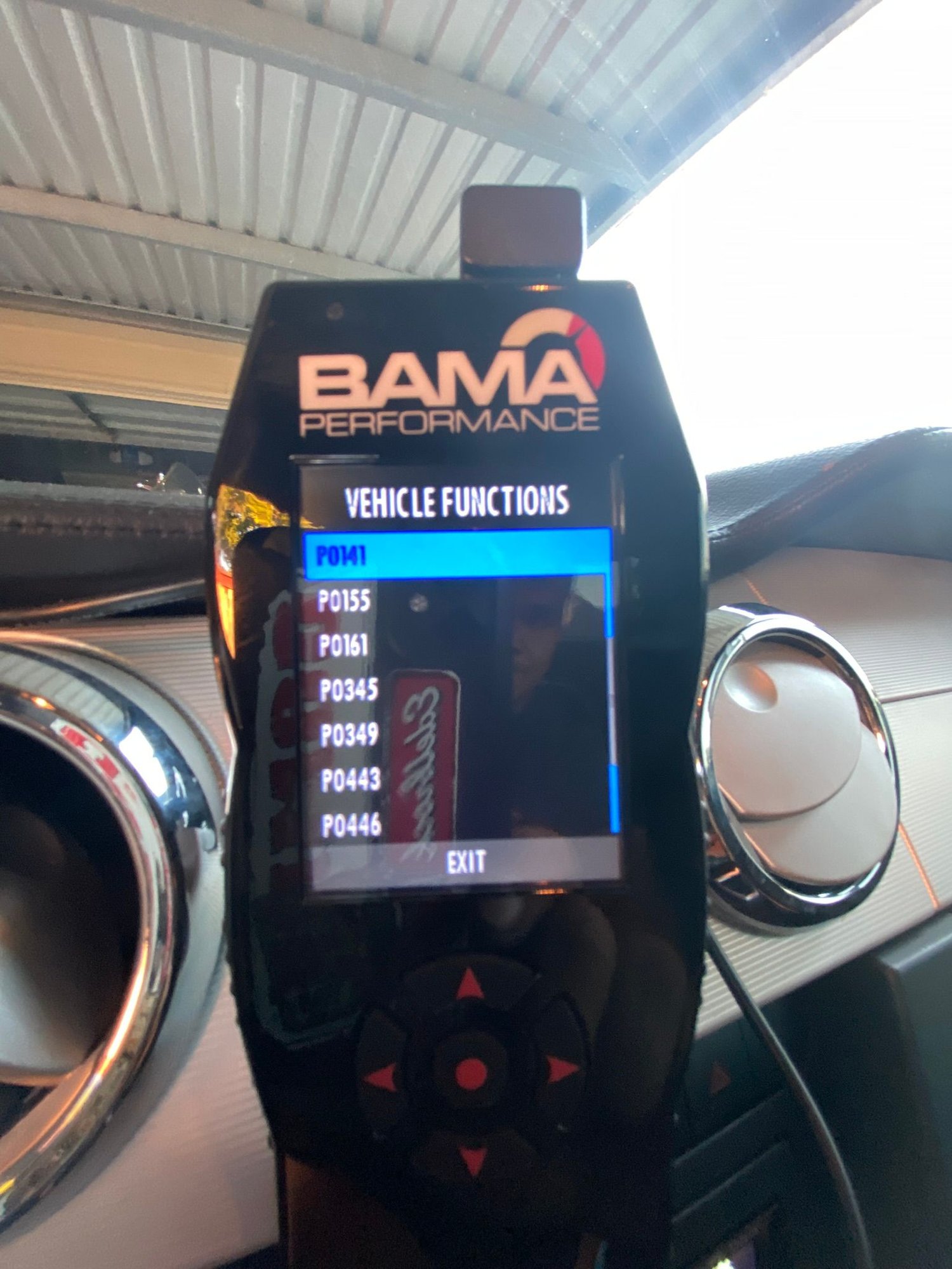

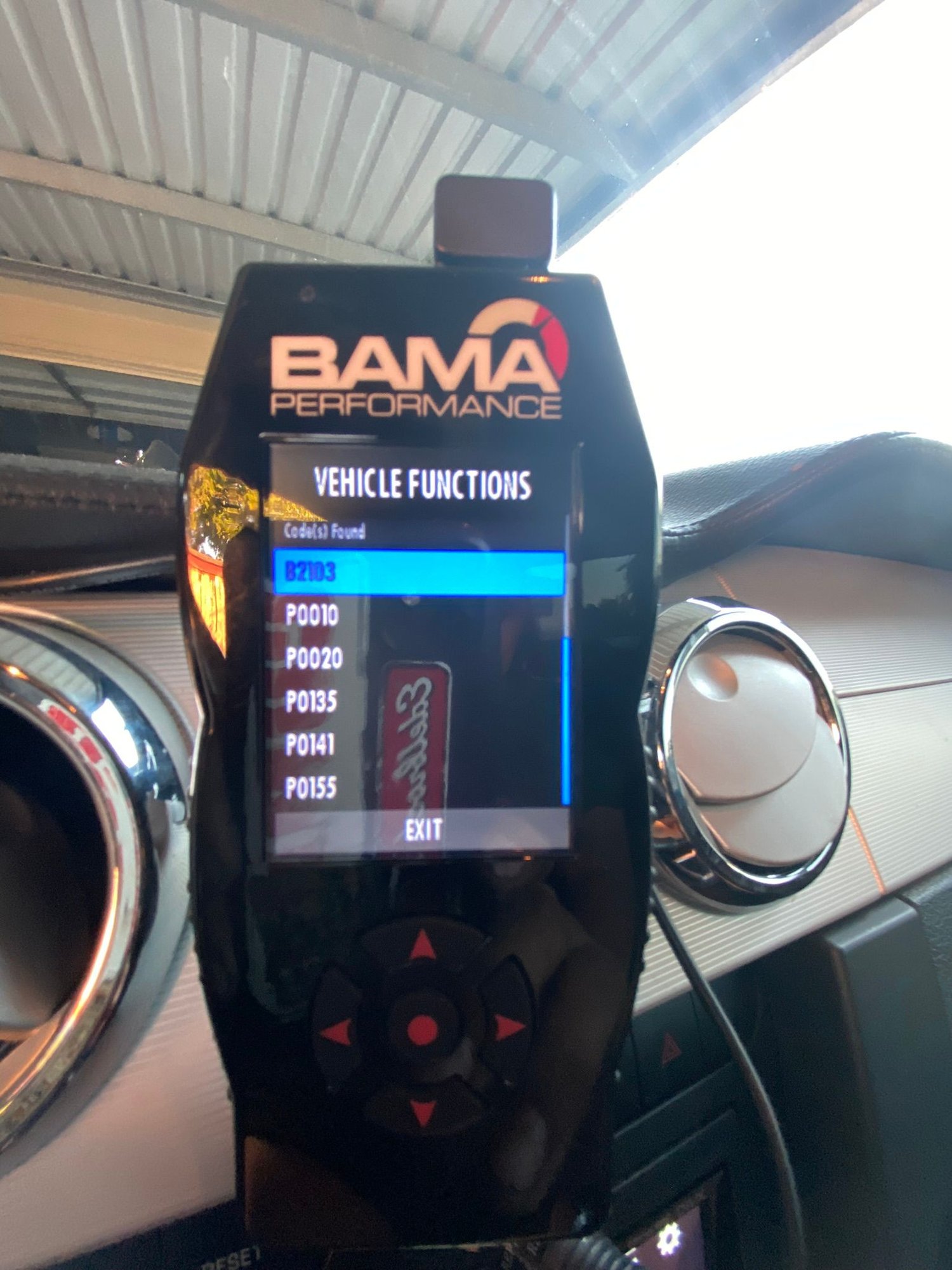

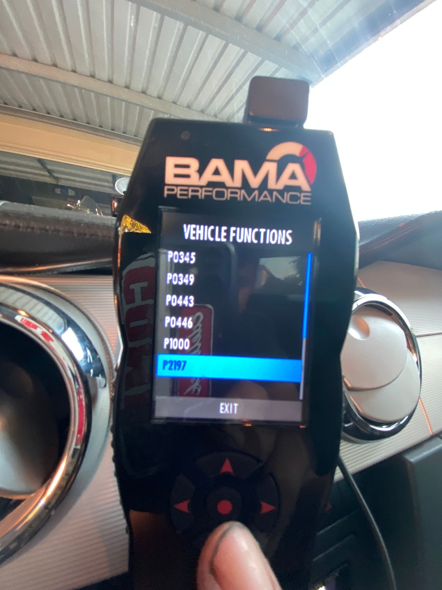

So these are the codes I have. I will pull the valve covers off later today but is there a certain amount of rotations on the crack I need to do until I can verify the timing?

several of those are cam timing related so...i'm going to guess something went back together wrong.

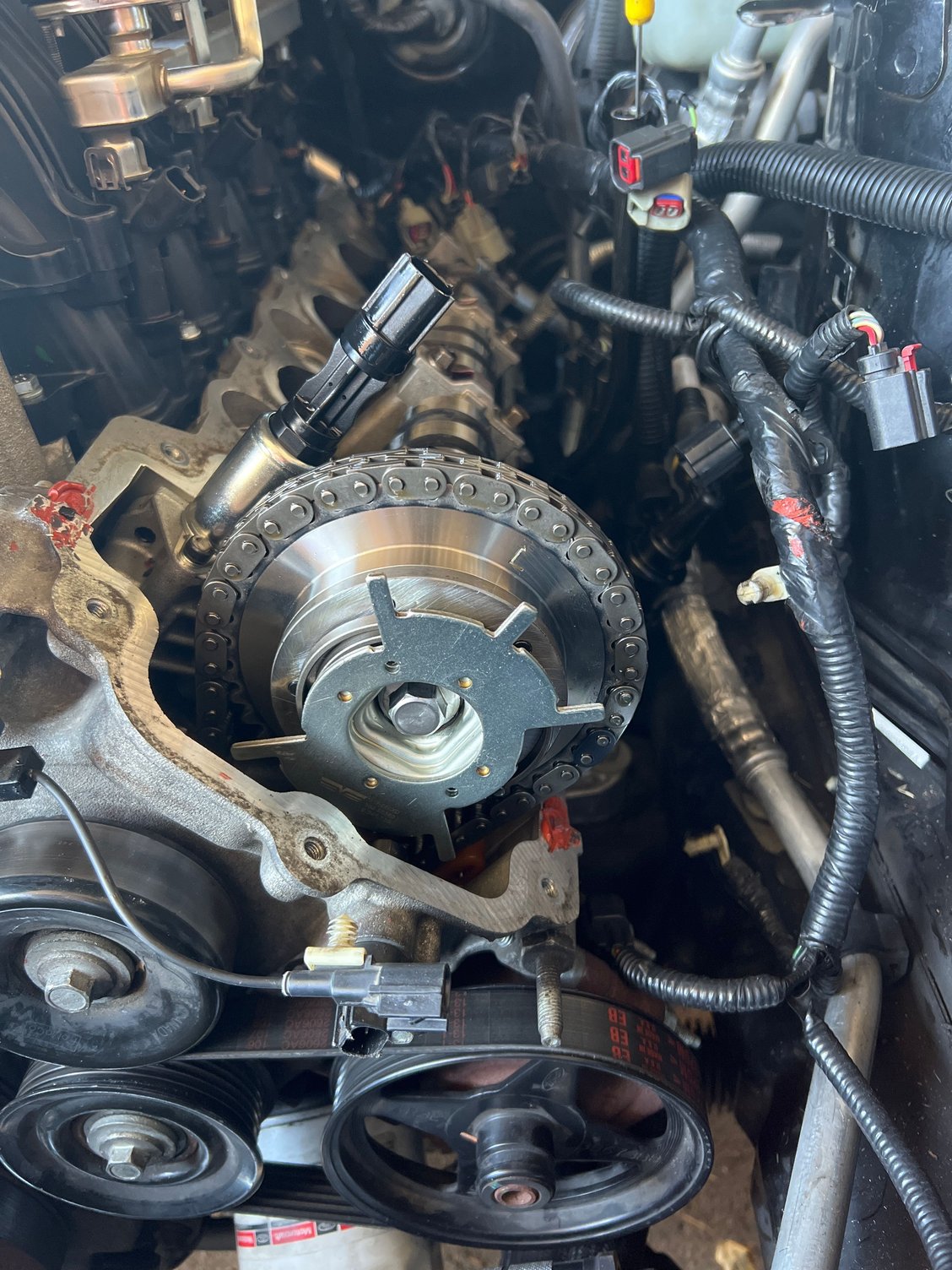

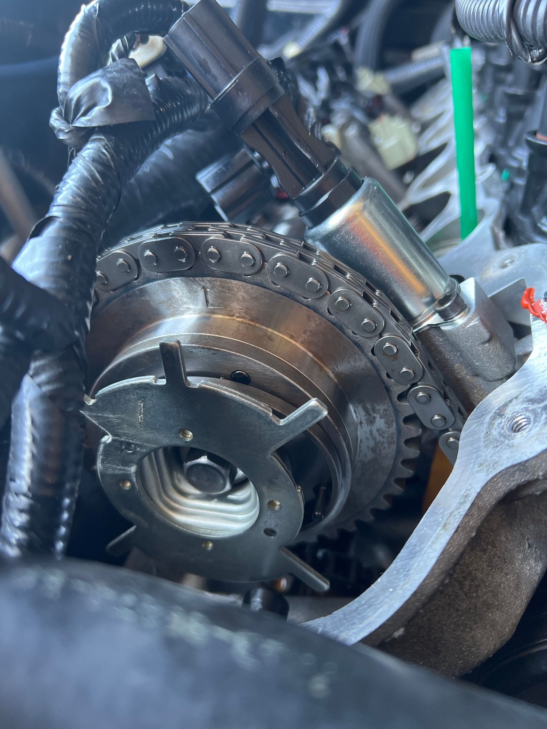

I believe passenger side is off

It's hard to tell from the angle of the photos but I also think the passenger side is one tooth off.
