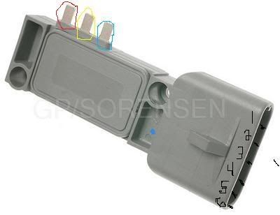

Default RE: engine sputtering
i will try to find a pick right quick of my car with it so i can circle it for you and post it. in the meantime read this that i wrote up for someone not long ago.
OK I KNOW I FAILED KINDERGARDEN BUT THIS IS THE QUICKEST I COULD DO THIS
with your multimeter you will conect the neg on one connector and the positive on the other and no it doesnt matter which one is on which as long as the connectors are correct per the following chart
RED= GRND (GROUND)
YELLOW=PIP PWR
BLUE=PIP IN
1 PIN= PIP
2 PIN= SPOUT
3 PIN= START
4 PIN=TFI POWER
5 PIN= TACH
6 PIN= IGN. GRND
ok now that thats all established set your multimeter to ohms and test as follows.........
GRND to PIP IN should read greater than 500 ohms
PIP PWR to PIP IN should read less than 2000 ohms
PIP PWR to TFI PWR should read less than 200 ohms
GRND to IGN. GRND should read less than 2 ohms
PIP IN to PIP should read less than 200 ohms
if any of these readings arent as stated above then your control module is bad, if they are all good then you prolly have a bad stator

heres a pic of my motor, im assuming your distributor has one of these on it. the TFI module is circled in yellow
