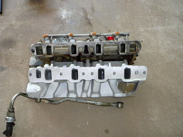

FYI - The upper and lower intakes are not hard to get off, just have to buy a few gaskets. also I called edelbrock for the plate and they sent it to me for free, if you do that, don't forget to ask for the rivits, I didnt' get any and had to drill and tap it for 1/2" 1/4-20 bolts. but it sounds like that's down the road.

HAH!!!
Finally found a pictue of the baffle plate installed on RPM II Lower intake
http://i9.photobucket.com/albums/a74...ockIntake2.jpg
Enjoy

Thanks for the pic and info mattkoly, appreciate it. I have come up with a solution. I removed the basket with the steel wadding, and inserted a quarter in the end facing the lower intake. Took it out for a beating and signifigantly less oil was pulled through the PCV. I know this is nuts, but it worked. Only a few drops in the air/water separator, instead of it being nearly full. I will go the baffle route, just don't have time right now.
