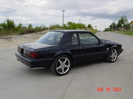

When I got my fox, it was already converted to 5-lug, and was sporting 18" Moda R6's.
(Not mine, but a better idea of what it looks like)
I thought 18's were kinda big for the fox, and I like my rims to have lips on them, so ordered some Cobra's from a 98 mustang on Ebay.
