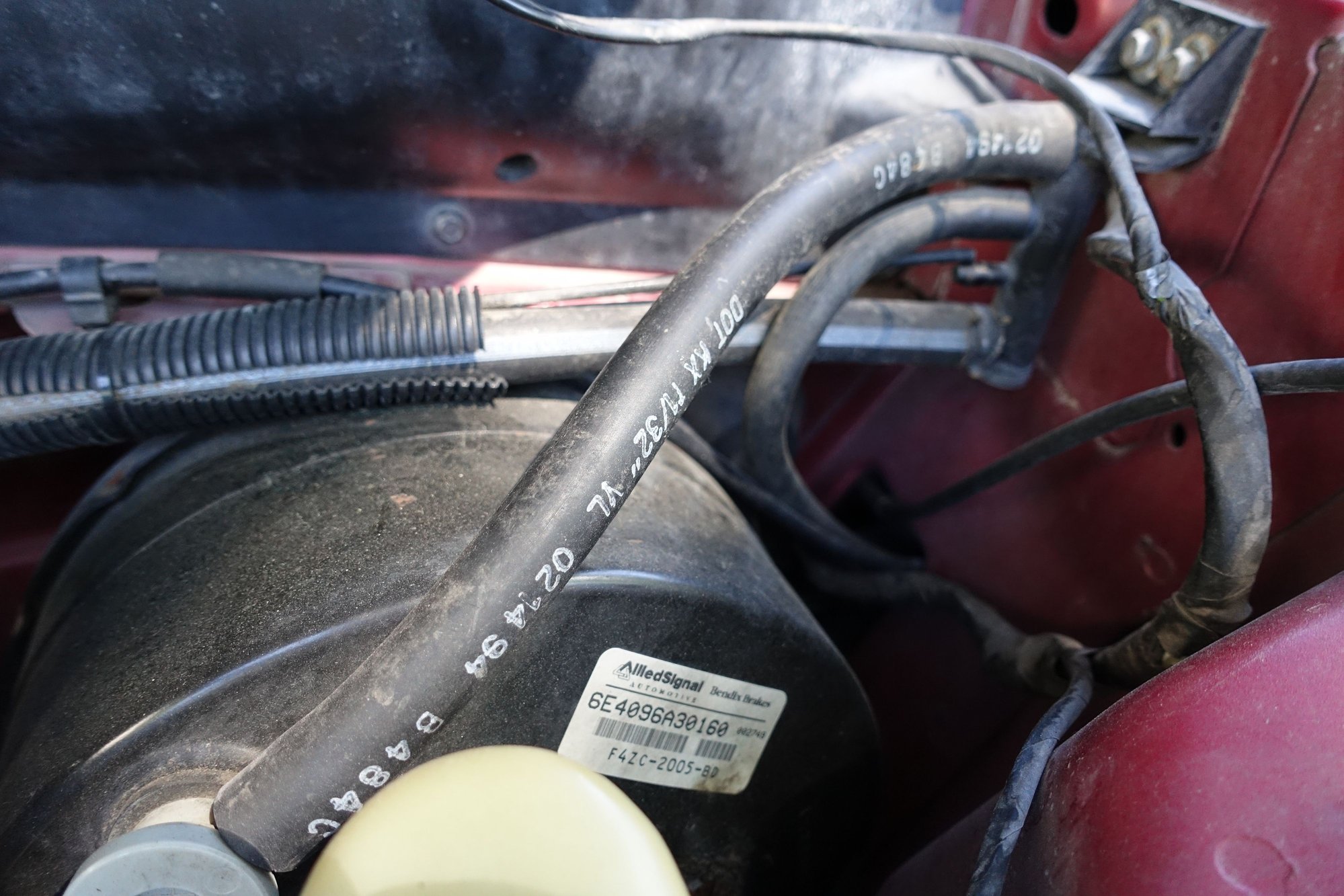

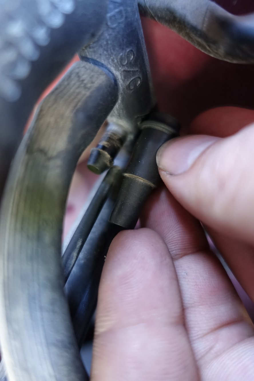

I saw that a hose was completely detached and after investigating, I have no idea what it does. I need to get a replacement connector because the old hose is stuck inside and I pierced the rubber when trying to get it out with a needle. I need to connect this very small tube to a larger piece. Does anyone know what this hose does or what the connector part is called? It's in the driver side of the engine closest part to the interior. Thanks
This is the connector piece I need to replace
Heres the location its on the right side of the pic. The small hose leads to the interior.

Im kinda thinking that line goes to the HVAC controls. You should be able to use a bit larger piece of hose to go over the nipple, then use some epoxy and glue the other line inside of it.

Yep, your HVAC is surely stuck on defrost right now. I had the same thing happen last year.
If you can't re-use the nipple, try a parts store. They might have something like this in stock. You could also try a salvage yard...

I got the exact part you recommended and it works perfectly. Thank you!
