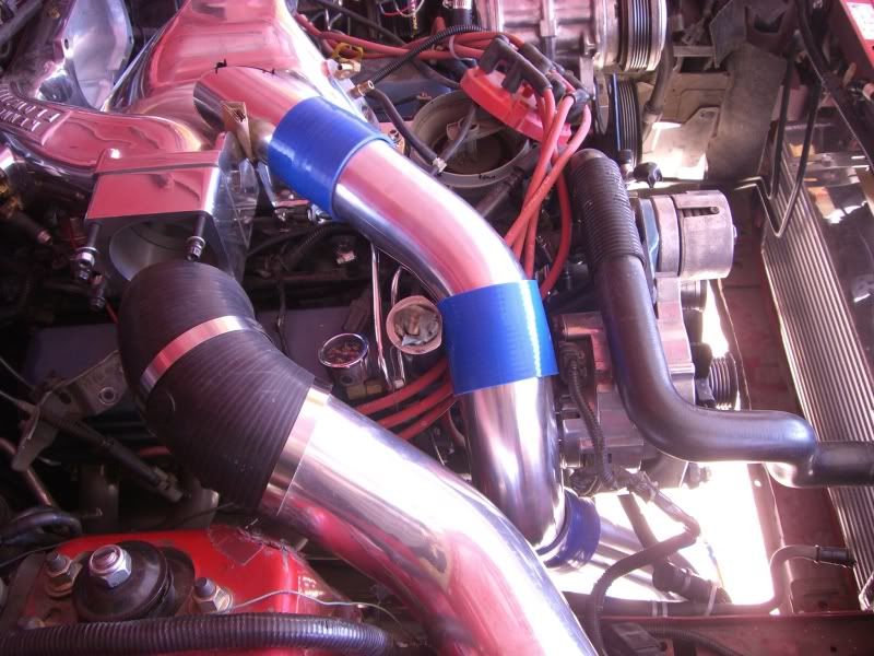

The KB is installed and got the bypass pipe this morning from the welder. On start up it revs to about 3 grand and then cuts out, did this like 10 times. I checked everything, looked for vac leaks or unplugged sensors and found nothing. I tried holding the throttle open a bit and was able to get it run at 3 then 2k for 3 minutes then slowly let the throttle down until it finally idled. I Let it warm up and then went for a short ride. First observation was the KB's wine now is much louder, must be due to the thinner pipe comming off the manifold is resonating the sound out throught the pipe and intercooler. Sounds really sweat now, love that KB wine. The car runs well at cruise and responds well to light throttle jabs, very responsive, no stumble or hesitation. Now if I let off the throttle and coast it will sometimes stall. I'm gonna try resetting the idle and check TPS volts. I'll let you know. Its funny now it starts no problem no more high reving and cutting out. I have to burn out my old winter gas before I romp on it. I was able to get some cruise and light throttle data. Outside temp today is 52 degress, 4th gear cruise at 2500rpm showed ACT temps of 70 degress. So 19 degress above ambient, so far the intercooler really looks like its working well. I'm very happy with the results sor far. Even more interesting was how fast the ACT temps change now. When I crack the throttle open the air temp immediatly goes down, and i was only going to @ 20% throttle so I can imagine full throttle will result in even lower ACT. Stay tuned because I'm just getting strarted, havn't even tried the meth yet. :-)

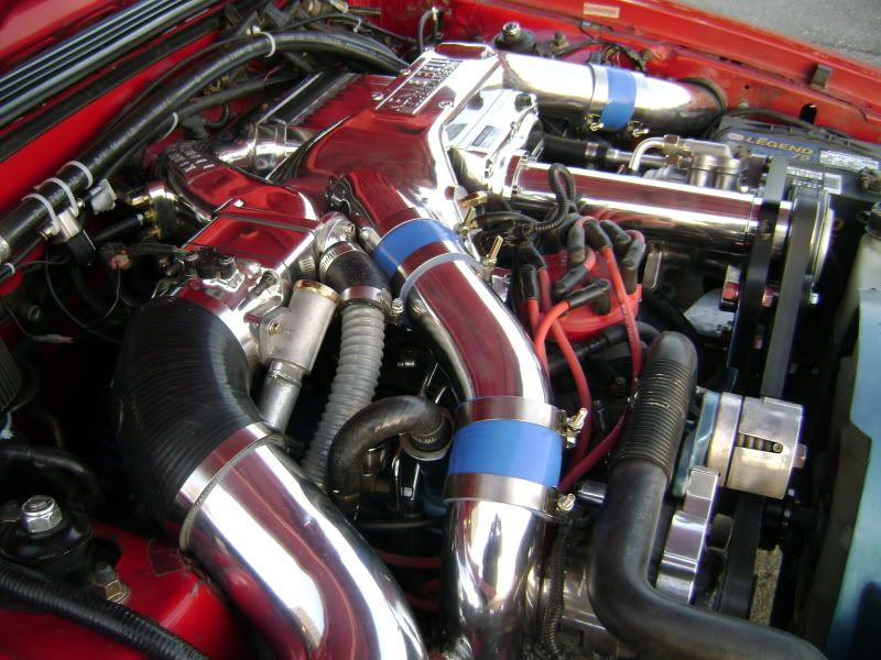

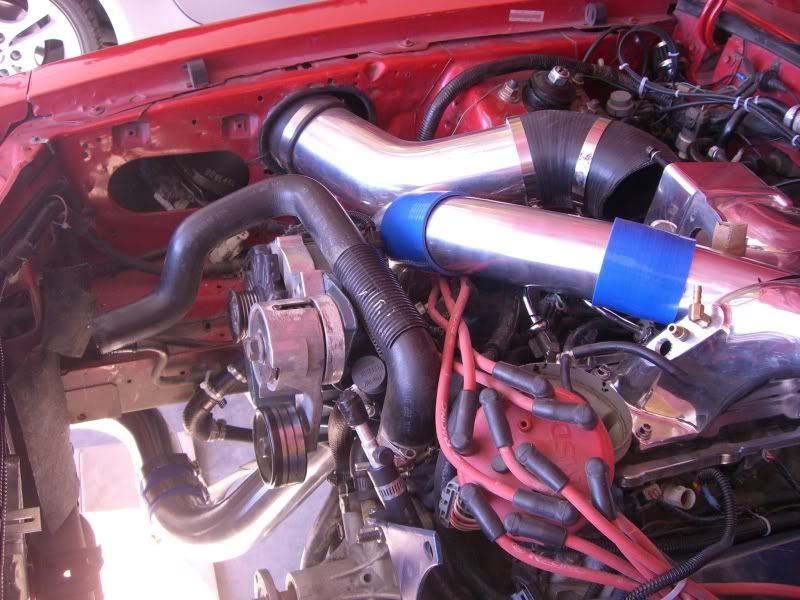

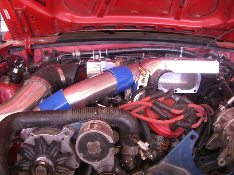

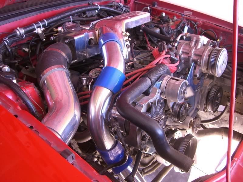

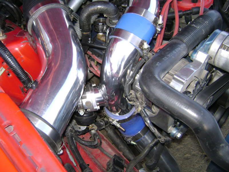

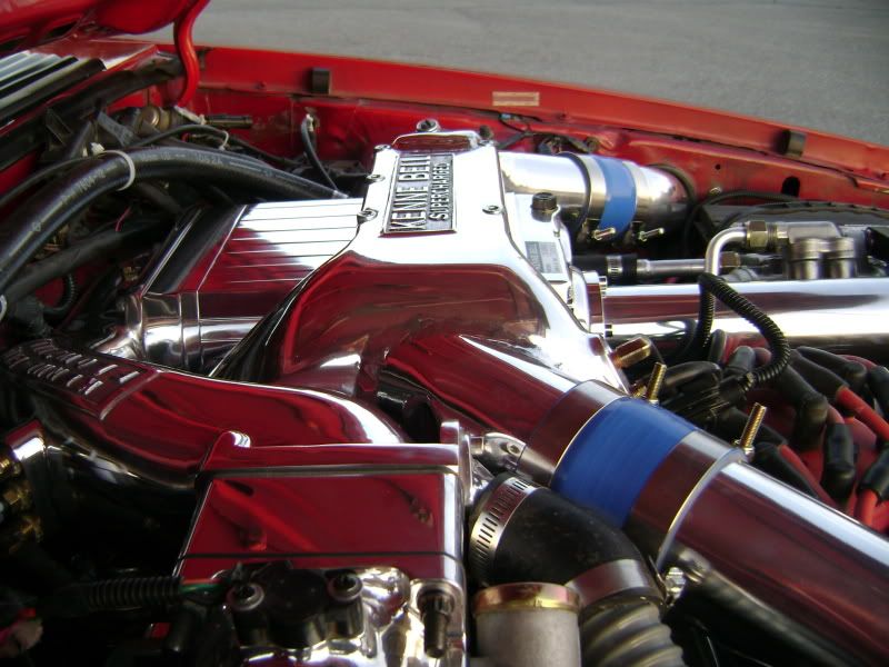

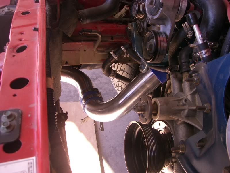

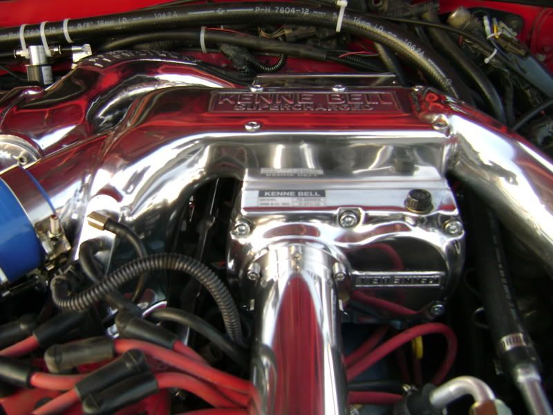

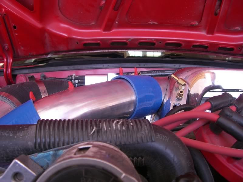

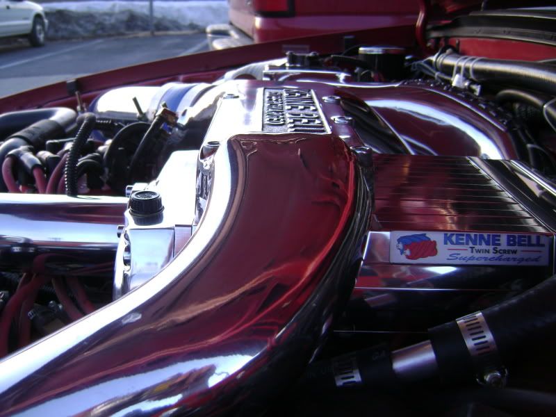

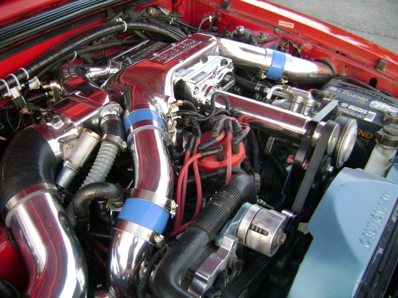

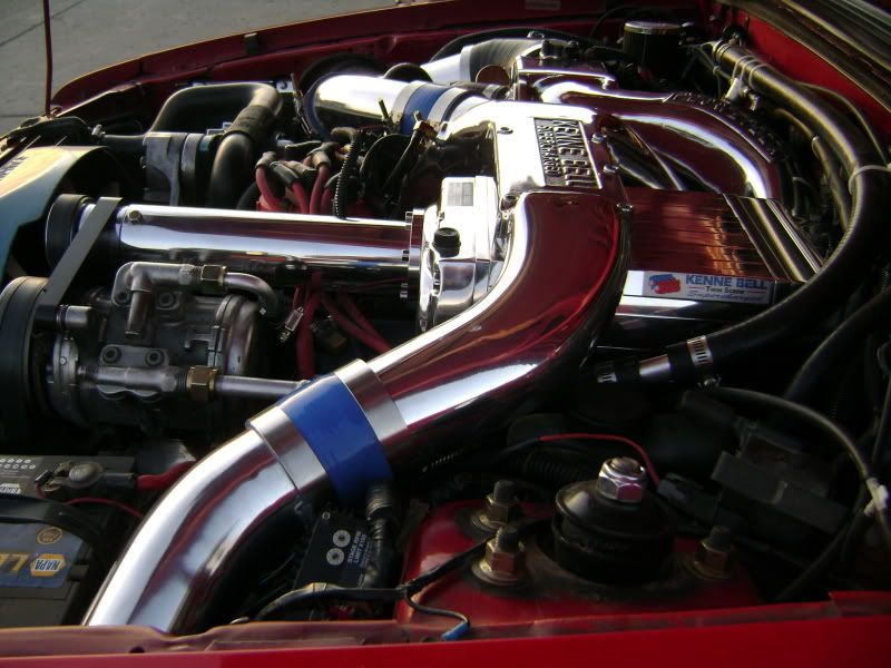

Got some pics pics of my Frankenstien Kenne Bell. Check it out.
