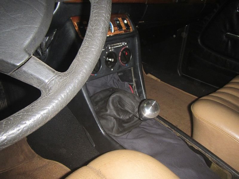

shift lever reshaped to clear console.
No room for radio. Fabric temporarily covers wires. Note tach is a little off center.

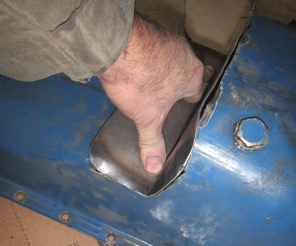

Use a 1/8" cut off wheel on an angle grinder to cut the pan. Smooth the edges with a file. Hammer a little to straiten things out.

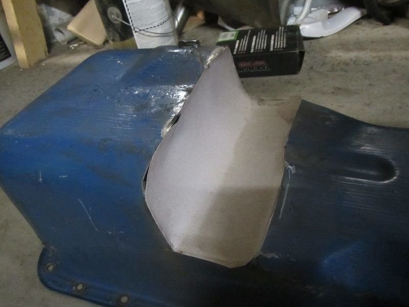

Make a pattern for the patch using a piece of chipboard from a cereal box or the back of a notepad. I like to use the "grubby finger" method for marking the cardboard. Just press the cardboard into place and rub your grubby fingers over the edge. It makes a perfect line matching the hole. It also works pretty well for placing holes for drilling and the like.
chipboard pattern in place

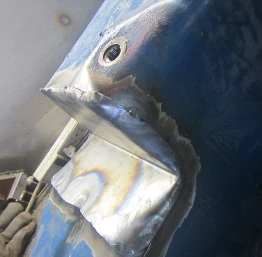

Tack in place and hammer more to close gaps.
Finish welding it in place. I used oxy-acetylene and a Meco torch with almost no filler rod. No leaks first try! I tested for leaks using a little isopropyl alcohol stained with water-based red paint.
