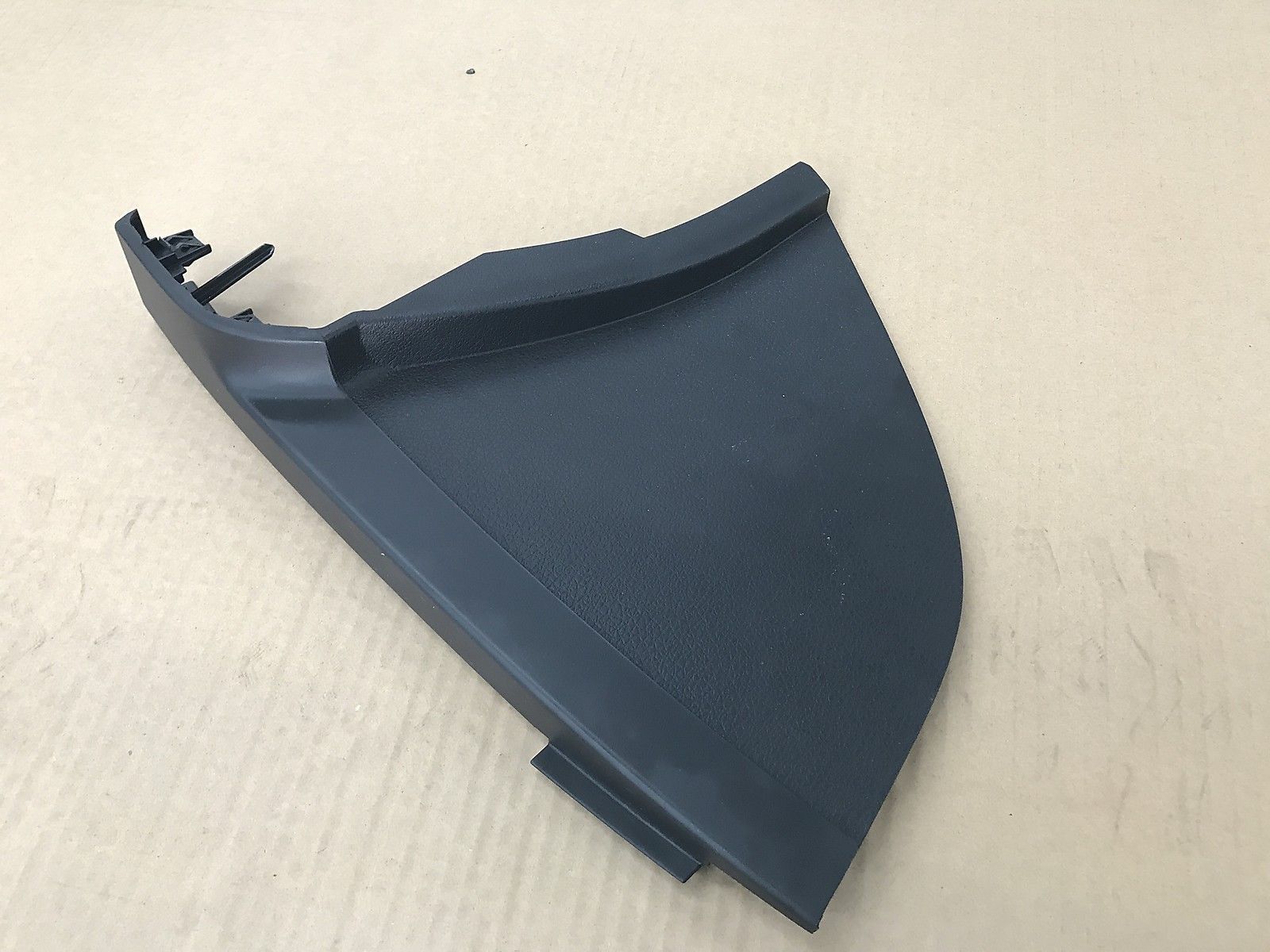

They pull out, like most other panels. They're in with the plastic tips with
metal tabs for the receiving slots. Sill plates, sill trim, kick panels, "A" pillar,
all that, pulls off with those tabs. Sill plates may also have 3M double sided
tape on those, mine did, you will need to redo that before snapping them back
down.
Most of these also have plastic guide dowels for alignment, when mating up to
another piece.
The deck trim piece has push in fasteners behind the seats, but the side panels
also need to be popped off.
Dash trim, pops off too... Different clips than the other trim panels.

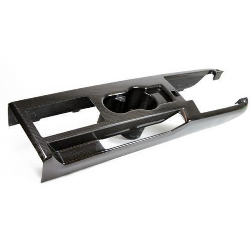

Console, pop the shiftger bezel off, and then there are two screws at the back, under the arm rest,
then pull the ER brake handle up, and pull the console piece up, and slide up over and off the ER brake
handle and off. The ER handle has to be up high enough.
DASH PIECE EXAMPLE:

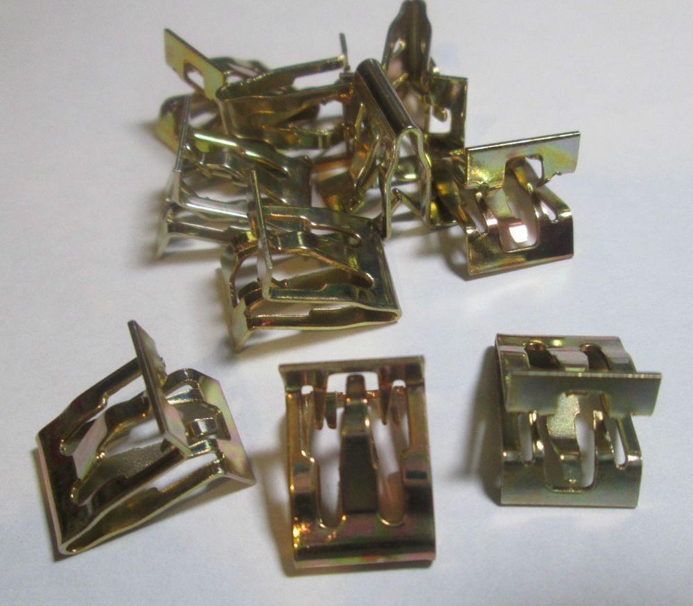

With the others, the tabs on the trim pieces are plastic, but they have the
metal clips over them:
If they break, then you lose the fastener... SO, when you pull them off, pull straight on them,
and try not to wiggle or angle too much as to not break them off. Sometimes, the panel will
come off, the metal clips will stay in the slot, but the plastic tab is fine. You only need take
the metal clip out of the slot and slide it back on the plastic tab.
