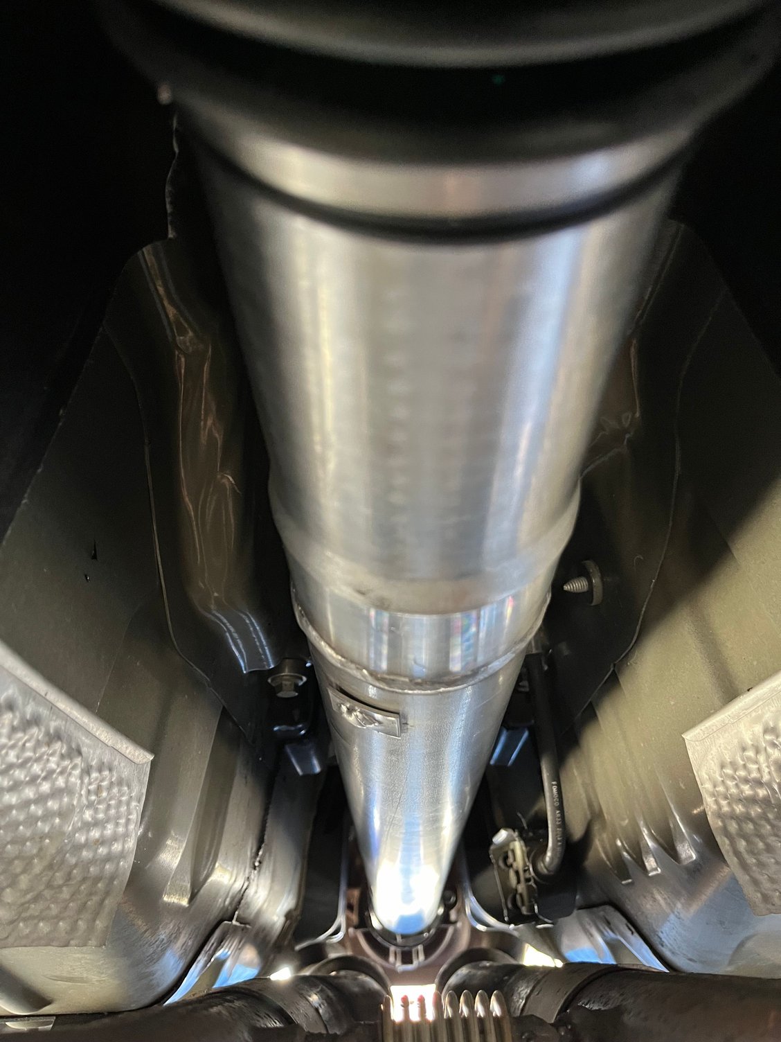

Yesterday I installed a Ford Performance Aluminum driveshaft in my 2014 Mustang GT with 6 speed manual transmission. The installation was done with the car front end up on steel ramps and the rear axle supported on two 3-ton jackstands. Total time was about 2:45hrs with a friend helping. We were able to leave the exhaust system installed and only had a few issues with the extraction and installation of the new DS. The biggest problems or challenges was getting the 6 rear flange bolts torqued to 41lb-ft. I was able to torque the two 13mm hex head bolts using a 13mm flare nut crowfoot wrench from Teckton. Teckton confirmed the wrench was tested to 50 ft-lbs. Even using this I needed an extension to clear the u-joint as the torque wrench would contact the u-joint. The 4 8mm hex key bolts were also a challenge. After snugging them down with an 8mm hex key, I used an 8mm key / 3/8ths drive with ujoint and extension. The hex key was a tight fit and was actually snug against the ujoint bearing cap but we were able to do this as well. I guess my question is why the hex key bolt selection for the rear bolts and not use hex head bolts like are supplied for the two that are under the ujoint caps?
At any rate the vibration that used to be there starting at 48mph and going up to about 80mph when it seemed to me to diminish probably because the frequency was so high, that vibration is now gone. A secondary observation is that the clunk with shifting in the first 3 shifts is very much reduced, a lot. The clunk with power on / off is also very much reduced. I attribute most for the clunking to the carrier bearing rubber isolator having become so soft that the driveshaft was essentially banging around in the carrier bearing mount when power was changing and to a lessor extent to additional slack I can feel in the whole original driveshaft. Hopefully this problem is now resolved.
Ford Performance Aluminum driveshaft part number M-4602-MGTM
