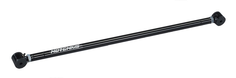

Match that Eibach kit up there with a good panhard bar like the one I have on my Mustang from Hotchkis, and you're all set. Reason why you need this panhard bar is because when you lower live rear axle vehicles, the axle shifts over depending on how much you lower it. For you, you'll need to adjust about 1/4" of an inch over back to center after it's lowered, so you really do require it. Luckily though, they're not too expensive:
Hotchkis Adjustable Panhard Rod Mustang
