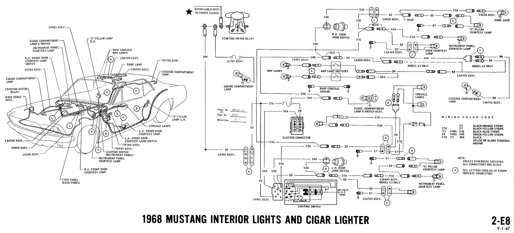

We could find a wiring diagram for something like headlights on line like this:
We can see that all those interior light feed off of the battery and its first stop is the solenoid. So the easiest guy here is the eng compartment lamp if you've got that. Does it go out? Wouldn't it be nice to know if power was getting to the Solenoid? IS it getting past the solenoid? How far past? Enter Digial multimeter
