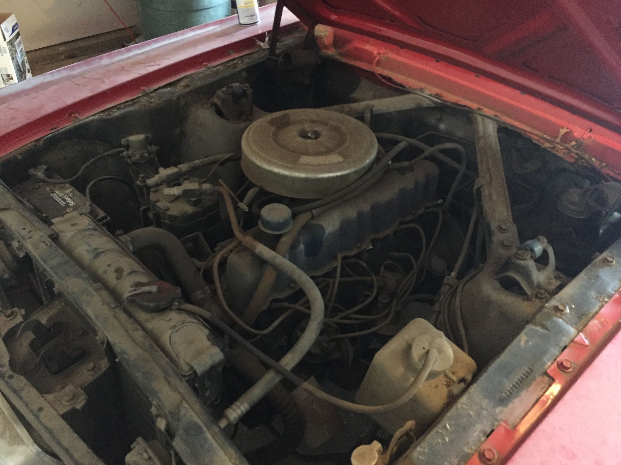

I recently purchased a 66 that shows 30,000 on the odometer. The title is from 1988 and shows 24000. The last time it was registered was 1992 and it sat in the PO's driveway since then. The car is rough but the engine looks new. I am thinking 30,000 is the real mileage but have no way to prove it really. It is a Sprint edition with the console, A/C, Auto, and chrome air cleaner. But it also has the chrome faux side vents. The floors need to be replaced but all the other metal is good and I can only find surface rust. No power steering or brakes My intent was to fix it up myself as a driver. It is red and the original color is Turquoise. My question is with this low mileage would this be a valuable car if fixed up. I think it would take a lot of money to really fix it up and I'm not sure tis worth it. Should I fix it myself and have a nice driver? Thanks for the input.
Also has the blue center hubcapsTrunk is solid with just surface rustvery dirty but the blue of the engine is still good and looking in the breather it is really cleanInterior is probably the worst part. Dash is cut for the radio also

If that engine looks “new” to you, we have a different definition of the word.

that engine looks about as "new" as my 95 year old grandma
