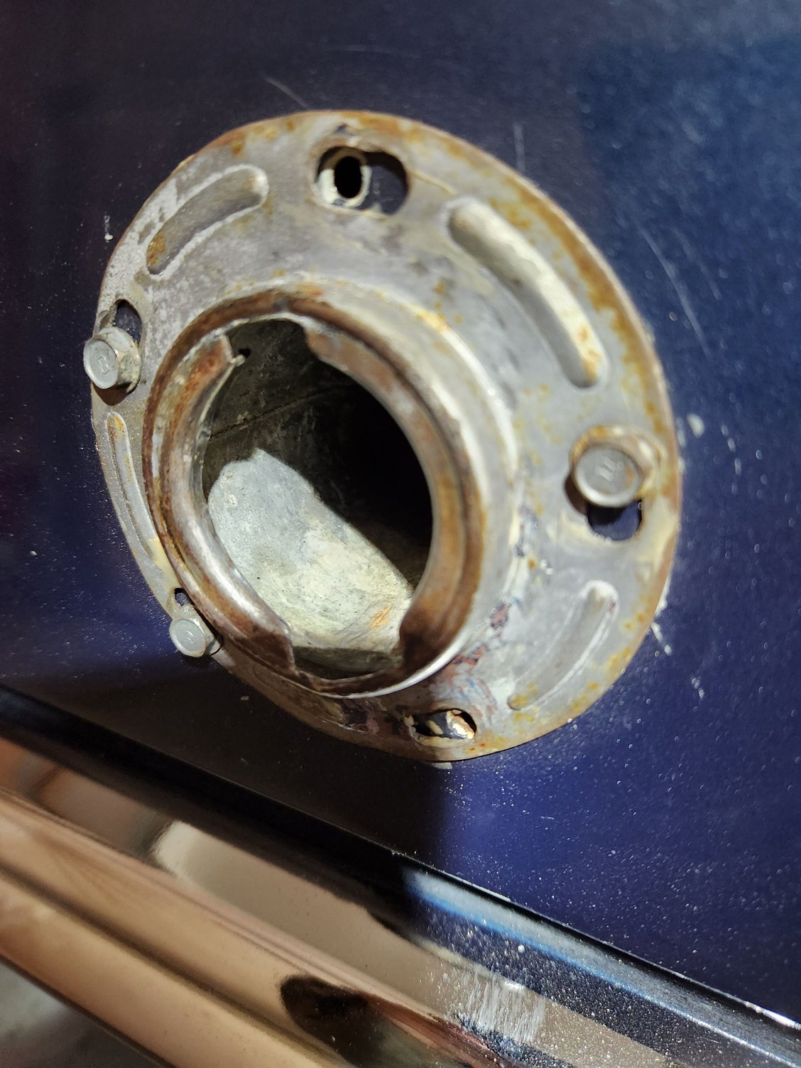

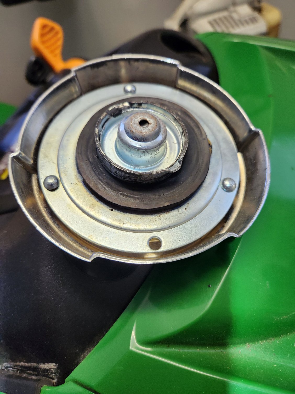

@Mustang 66:
Thanks for your reply. I attached some photos of what I have, since I couldn't identify what you describe.

Yep, right there ->
