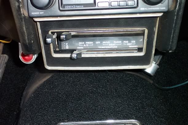

mines complicated.... i dont know where the "i just want a little air to blow in" area is.
yours is easy too. the lever to the far left is the fan, up is high, down is low (i believe that's what it should be). the top left to right slider is your selector. in the pic you have it on max a/c from what i can tell, next one over is norm a/c, than off, dash and floor vents, just floor vent, than ice defrost and than defog. your slider on the bottom is cold to hot, left to right.
hope that helps
hope that helps
