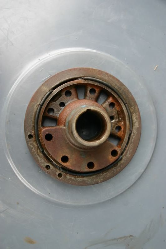

Can that seal be replaced? Or is it better to buy a new harmonic balancer? Its kinda beat up anyway.

euhh, just buya new one, i thought mine was bad but its nothing like that![:'(]

REPLACE IT!!!!!
heres a link to a quality, better than stock yet cheap balancer:
http://www.northernautoparts.com/Pro...ctModelId=5968
they make this in a 50 oz as well. they have 3 and 4 bolt pulley patterns and three sets of timing marks. they say they are good to 6000 rpm's but ive spun mine up to 7000 many a times ; )

That isn't a seal. It's part of the damper.
Go aftermarket for a replacement. You'll want the same weight as what you have (28oz for early, 50oz after mid-81). Fluidampr and TCI make good replacements. 6k rpm is nothing for a 302, so shoot for something that's rated a bit higher.

ORIGINAL: my77stang
REPLACE IT!!!!!
its says its a hi performance one but willit bolt right up without needing any other performance mods?

your joking right? lol
agreed that a fluidamper or tci is a better choice - but i figured if the guy is contemplating using that disaster of a balancer something cheap yet better than stock would be in order.
....and again
