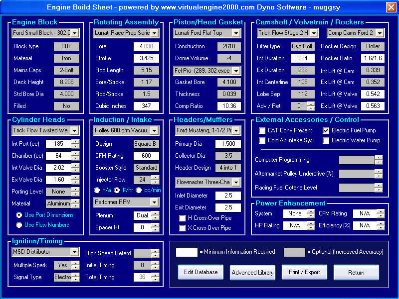

Hi, I am finally getting my short block assembled and picked the components, they are being installed next week. What a process! Anyways, would someone be kind enough to Desktop dyno this setup and post the pic of the power curves? I am curious because I need to get my transmission built and want to know if I'll need to do it right away or if I can wait til later this summer and how big a stall converter I'll really need...thanks in advance, let me know if you need more info:
347 short block
Bore: 4.030
Stroke: 3.40
Compression: 10.25:1
Intake: RPM Performer Dual Plane
Carb: Holley 600 CFM (for now)
Heads:
Trick Flow Twisted Wedge CNC Ported
64cc combustion chamber
185cc intake
66cc exhaust port
Valves: 2.02 intake, 1.60 exhaust
Cam
Trick Flow Stage 2 hydraullic Roller Cam, 1.6 roller rockers
Lift: .542/.563
Advertised Duration (Degrees): 286 intake/294 exhaust
Duration (Degrees)at .050: 224 intake/232 exhaust
Lobe separation: 112 degrees
Headers: Tri Y, Dual exhaust, H Pipe

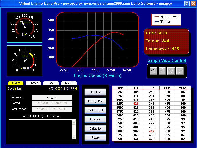

Your carb is holding you back a little. If you see mostly street driving though, I wouldn't worry about it. If you are trying to shave every last tenth of a second, a upgrade would help.
