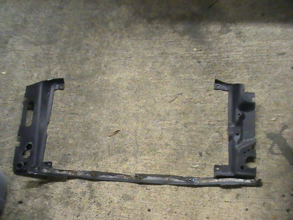

Radiator is 31" x 16", dual pass, inlet and outlet on the drivers side, filler neck on the passenger side, dual 13" 1720 CFM fans and shroud:
Anybody recognize these?
A big hole here, I will reinforce it with a piece of angle. I had to remove the A/C condenser and the brackets, cut them, move them to the back of the condenser, bend the lines a little, but it all lines up now. More pictures when I get the upper bracket to the radiator welded on. The lower radiator mounts are just 2 pins ( 1/2" ) with a rubber insulator:
I can almost smell the rubber burning down the road!
