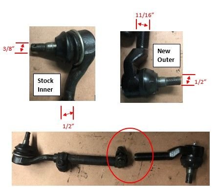

Its been a while since anyone has posted to this thread but i thought i would give it a shot.
I have a 1965 Mustang FB base model I6. I have upgraded my front end with a Street or Track coil over system, new big spindles and disc brakes. The new outer tie rod end that comes with the kit has a stud that is 11/16-18 and the stock inner end (which fits the stock idler arm) is 1/2-20. Is there a tie rod adjusting sleeve that has RH 1/2-20 on one end and LH 11/16-18 on the other where I have circled? Or is there an inner tie rod end that has a 11/16-18 stud and the correct ball joint taper stud?
