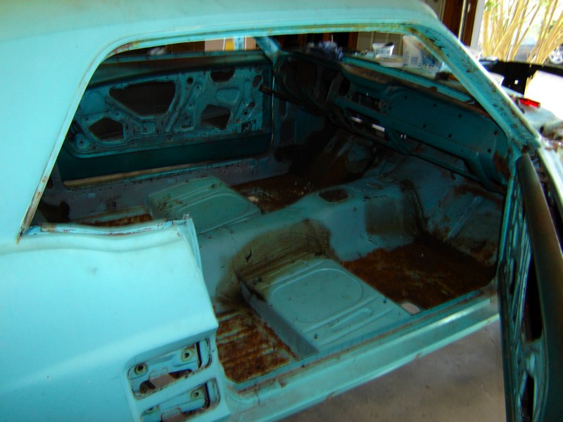

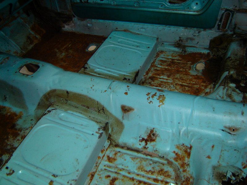

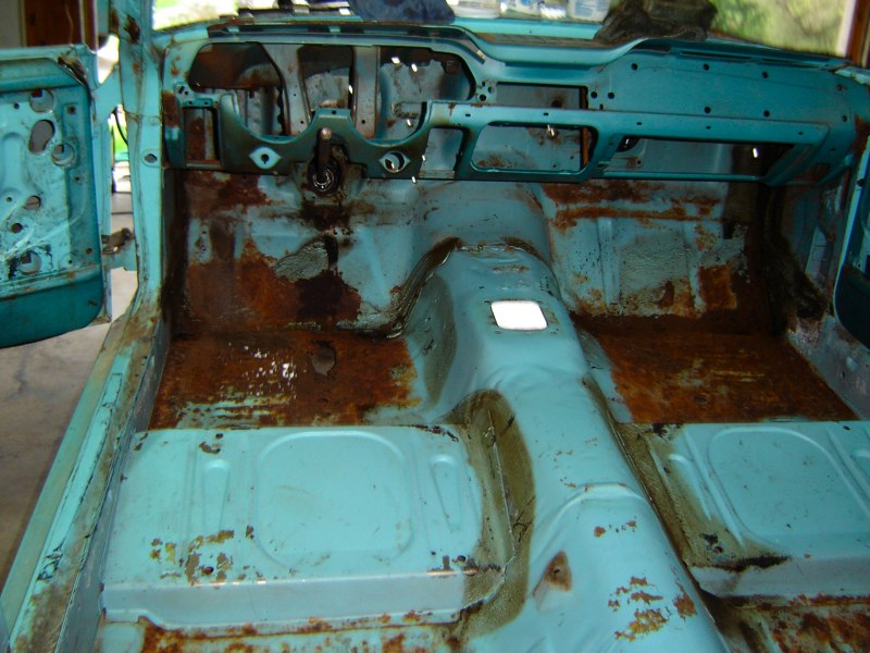

Here's some shots of my '67 which is basically the same as the 70.

Thanks, but I can't tell from your picture if the seat bases are dead level from side to side. I know how they go in. My only question is are they indeed supposed to be dead level from side to side. I would think they are, but mine weren't before I removed them.
