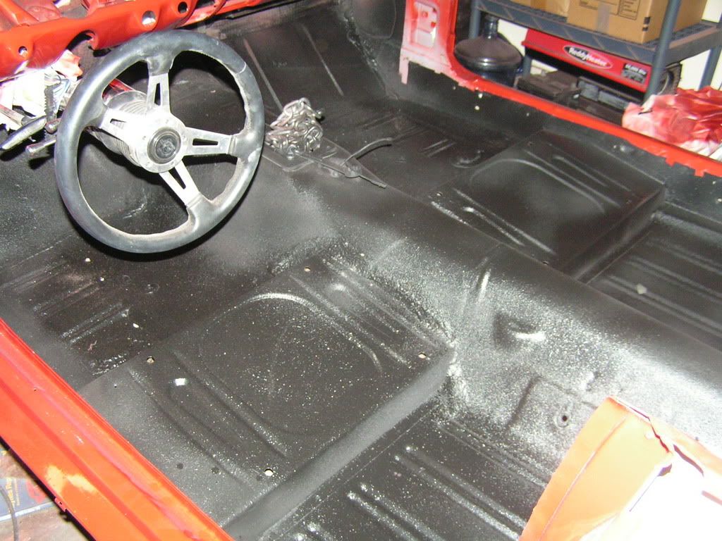

I used b-quiet and it works, it made an enormous difference. I have a nice super loud 351 W and the difference is amazing. One of my videos in my sig show the sound inside and outside the car.... I took alot of time on it and used 100sq ft... B-quiet was pretty cost efficient too... and that is always nice!
Here is a link to the stuff I bought:
http://cgi.ebay.com/Ultimate-B-Quiet...QQcmdZViewItem
I also used bedliner to seal the floor for extra deadening!!!
