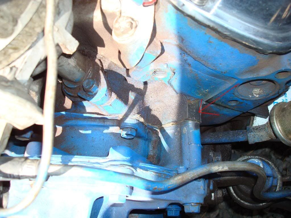

This may sound like a stupid question but...Where is the engine code on the block? I found one, but I'm not sure if it's the one I'm looking for. Thanks in advance.
here's where I found the code

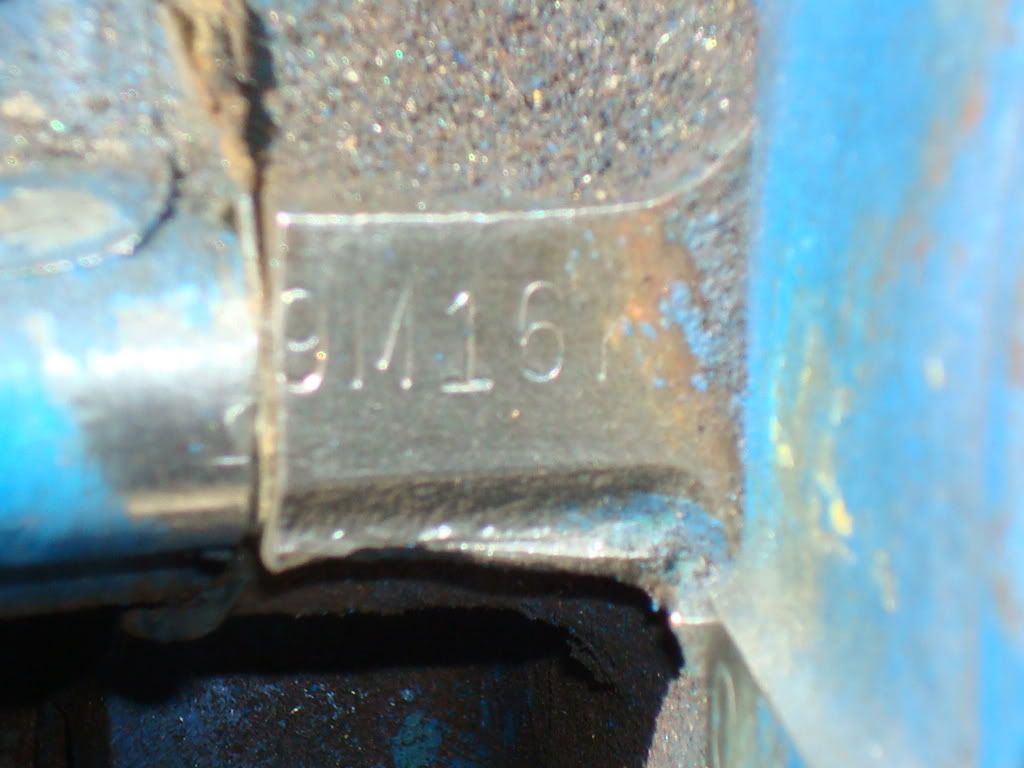

heres the code itself
Code
BTW, please excuse the dirty engine.[8D]

Looks like a date code.
If its a 65 block you should find casting e.g. C5AE and a date code behind the starter (you will need to drop the starter to see it)
Old Apr 3, 2008 | 05:05 PM
Passing Time's Avatar
Passing Time
Joined: Feb 2008
Posts: 78
Default RE: Engine code
If that's a date code I believe that means DEC 16 1969.

So what does the "M" mean.

Where is the "M" and are you sure its not a "W" if t is a W it may be the foundry mark. I am remembering this from an old casting Number bok. but I think a W is windsor foundry and a Cl is Cleavland. ignore the fact that its a windsor engine, both foundries made both widsor and clavland engines. for example I have a 64 289 Wndsor from the cleavland foundry. This cold all be wrong its from memory. Hope it helps.

m= december. here's the list:
A = Jan
B = Feb
C = Mar
D = April
E = May
F = June
G = July
H = Aug
J = Sept
K = Oct
L = Nov
M = Dec
(there's no I)
for the engine code itself you'll have to pull the starter
more info in the FAQ

oops. sorry I didn't see the links. thats part of the date code. I think its the month? a=jan b=feb...M=dec Dec isn't the 13h month. idk?

I looked it up. dec is M becasue they didn't use I because it looks like 1.

Second Digit
Month
A
January
B
February
C
March
D
April
E
May
F
June
G
July
H
August
I
Not Used
J
September
K
October
L
November
M
December
9M16
= 16 Dec
but the 9 could be 69, 79, 89?
the casting number behind the starter will look something like C('60s) or D ('70s) then a digit for the year within that decade (5, 6, 7 or whatever) then AE which means A - Ford, E - engine.
if it has something other than A, it can be for a specific line. B - Bronco, Z - Mustang (examples - and there are lots)
try this...it takes a while to get your head around
http://www.classicmustang.com/decoding_part_numbers.htm
