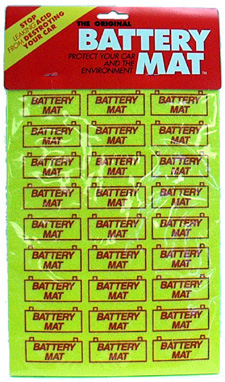

You might try a battery pad. I noticed that a few places make them to put under your battery so that it will not rust like that. My 73s battery tray has to be cleaned about every year.

How does a battery pad stop battery shelf corrosion.?I would think it would hold the acid mosture to the metal.

Here's what one ad says: I guess it is a "base" which neutralizes acid
Stops leaking battery acid from destroying your car.
The Battery Mat ® is made of super absorbent polypropylene needle punch felt, with one side heat treated to give it additional strength. This fabric is slowly pressure-treated at high temperatures with a unique, all-natural, acid neutralizing formula, and then cured in ovens. Finally, the fabric is dipped in a latex sealant mixture, again in ovens, and screen printed.
World's Only Acid Neutralizing Mat / Acid Absorbing Mat
Traps and Neutralizes Battery Acid
Recyclable
Protects the Environment
Protects battery from harmful road vibration
Easy to Install
Completely Safe to Handle Before & During Installation
Protects against Corrosion
Ideal for placing under batteries in storage
Used by all Branches of the U.S. Military
Can be cut to fit your battery tray
Instalation instructions included
Dimensions: Width: 8 in. Height: 12 in Thickness: 3/16 in
Also available in different sizes and by the roll - call for pricing
Made entirely in the USA

It doesn't really stop it, it does help keep it from starting though. it is pourous on top, but sealed on the bottom. Like a good "Huggies" diaper. Has a substance that neutralizes the acid and suspends it in the pad away from the metal.
Unfortunately since the battery manufactures had to change the composition of how the plates are made (EPA and really a good thing for our world) Batteries tend to gas more at a lower temperature & voltage. In our kinder and earth freindlier world the lead paste Pb and PbO2 (negative gray and positive red-ish) does not completely adhere to the mesh of the plate frame.
Now more than ever it is very important to use good battery tools (ie terminal puller, and terminal spreader) as well as the little felt washers and pads. I am at the point now where I pull the battery at each oil change, clean it and the surounding area with a good glass cleaner, then reinstall.
