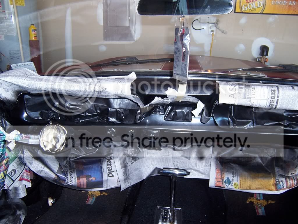

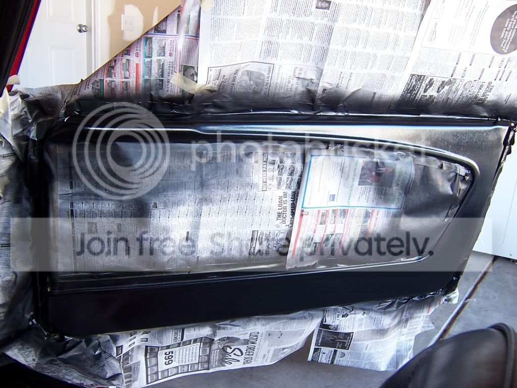

Well the good news is that I managed to get everything stripped off the dash tonight and the bad news is I manged to get everything stripped off the dash tonight....bad news in the sense that is only the first step and started thinking maybe the dash didn't really look that bad after all, LOL!
The in-laws are staying with us tonight and after diner, the boys opening some of their presents, etc we got the boys off to bed and then I was really wanting the "me time" in the garage so went ahead and got started to take advantage of the two long weekends when the dojo is closed anyway so my Saturday mornings when I would usually be in class are free.
It really only took me about an hour and a half or so to get everything off.
I have to admit I was a little intimidated when I first looked behind the gauge housing wondering if I would be able to get all the wires back where they belong. But then the idea hit me to use a sharpie and label "1,2,3, etc" all the places a wire goes and then I put a piece of tape with the matching number on the wires one by one as I unplugged them.
Also put everything in bags with labels such as glove box or dash pad, etc. I didn't figure I really "need" to take the dash pad off but I had messed mine up a while back and had found another on e-bay for $75 and have been putting off installing the new pad so what better time then as part of this job.
Hope to find some time tomorrow evening after all the "family stuff" to start scrubbing it down and prepping it for paint.
Starting to seem like this is going to be a chore but hoping it will look nice when done.
I'll try to snap some pictures along the way and post them.
