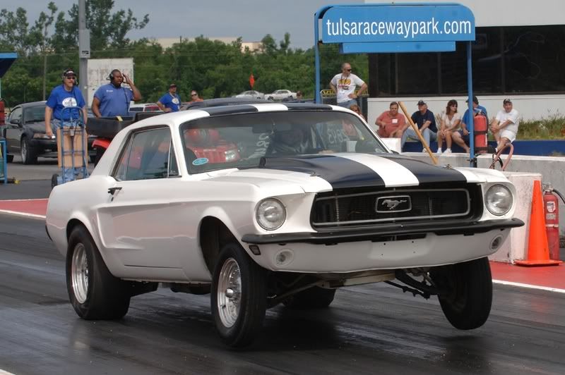

I had my stripes painted on when the car was being painted. As long as the guy measures it out instead of just trying to "eyeball" it then they should turn out ok.
The width and placement came from this car used to have a turn signal hood. I did like they used to and brought some stripes out of the turn signals in that hood. Unlike what they used to do, I took them all of the way back. When I put the windsor in it I needed a taller hood so I bought the cowl hood and kept the stripes in the same place. One of these days I need to get the front lower part done (front valance and the part in front of the grill)
