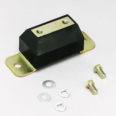

It's hard to tell if the mount is broken as the stock mount has rubber covering everything and often it flakes off. A poly mount like this one would keep it in place for about $30.00:
However, it is possible the bolts are simply loose. Those two allen heads that hold the mount to the tranny should be checked and then the two nuts on the mount studs that go through the crossmember. If they are tight, try jacking the tranny up slightly and see if the mount pulls apart.
