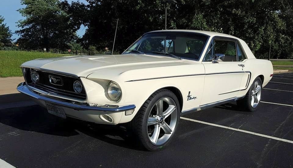

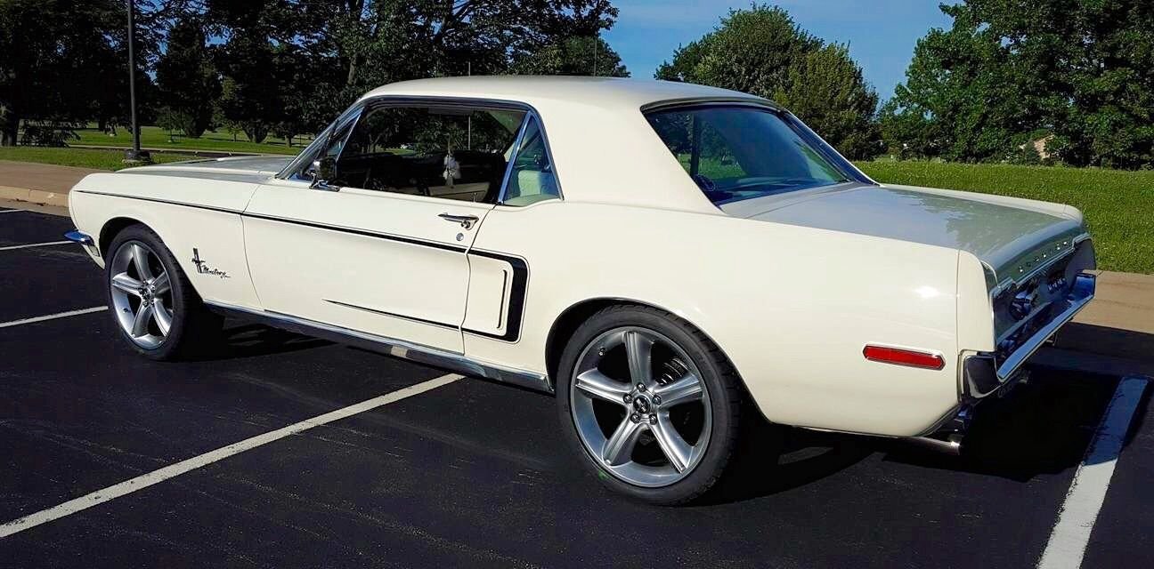

Old Feb 3, 2016 | 09:40 AM
  #160
Nebojsa Vujinovic Vujo's Avatar
Joined: Feb 2016
From: Serbia
opie, that is some big rubber you have on that 69 there! I would not have thought 18s would fit but doesn't look to be a problem at all with yours. Did you do some mods to the wells?
