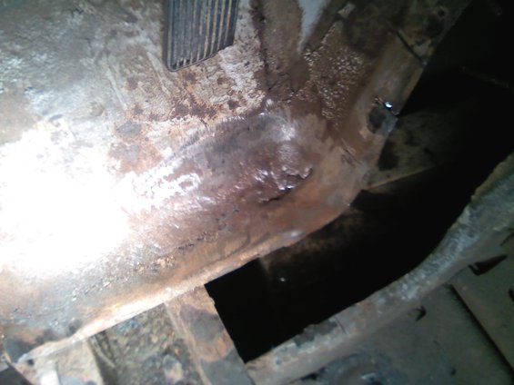

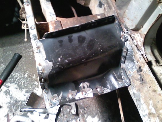

update in progress:
cutout driver side floors
new torque box installed
firewall had a little bit of rust thru
and driver side floor pan welded in
all i got left is some welding to join the two together. im taking it slow so it doesnt warp like crazy

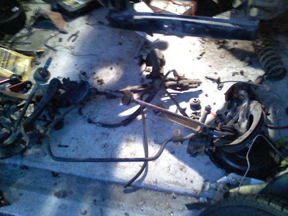

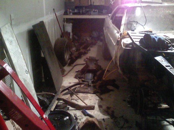

started stripping the car down to go get alkaline dipped and e-coated. it sucks having a small garage
front end completely stripped
old suspension and steering
thats all the progress so far. If anybody wants a stock suspension and steering set up shoot me a pm otherwise its goin in the garbage. i got a few other stock parts that im not gonna use as well.

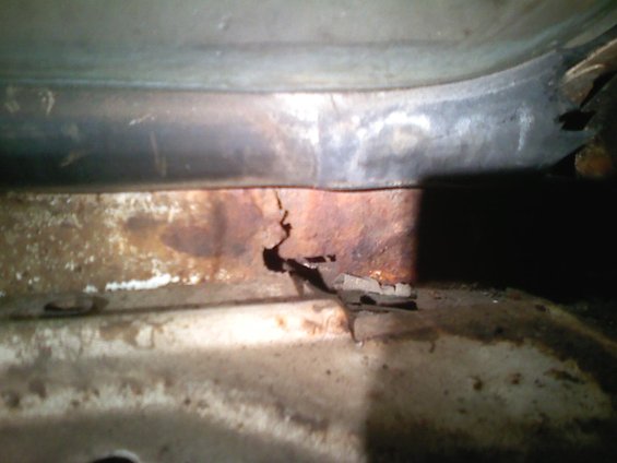

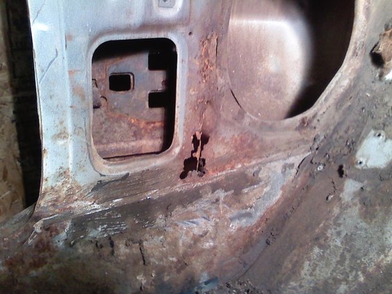

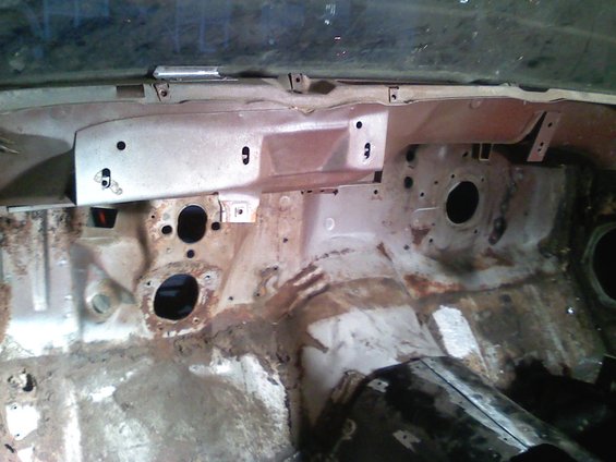

stripped out all enterior
some rust below rear glass
rust by firewall
lil more rust by back glass
