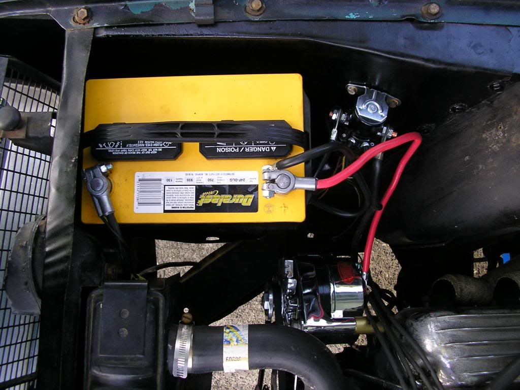

Also, I have the positive battery cable going straight to the alternator, with a secondary cable going to the solenoid. Would it make a difference if I routed the alternator power through the solenoid? Can I do that? Hook both the battery cable and alternator cable to the positive side of the solenoid? I'm just brainstorming here.

One note, I would change the wire from the alternator to the hot (front) terminal of the solonoid as well as the hot wire from the battery. Where you have it now is dependant on how much torque the battery terminal will support and I am guessing you are able to wiggle the cable with your hand (not good). On the solonoid, then nut will draw down solid and you will see less corrosion. The engine needs to have a ground strap from the body to the motor. I use two. On a side note, batterys can be bad even if they are new. A dead cell can draw a battery down and caust it to loose power in hours. I'm not sure how the automotive stores check this, but a specific gravity check on each cell will show it right away. The dead cell will stand out. Also I see the grond cable going down toward the radiator support but don't know where its connected. I suspect this may be a problem also, and if theres no ground strap to the engine, then thats what I would fix first before investing in a new alternator. Do you have a high wattage stereo?
