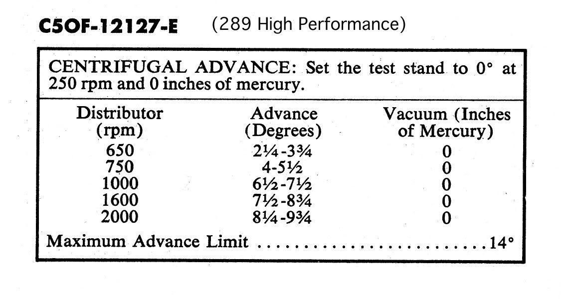

In regards to tuning the dist, what sort of an advance curve are we looking for? Total mech advance & all in by what RPM? How much vac adv? How much total timing?
Total advance is only a tiny part of distributor timing. The rate at which it advances, at certain rpm/vacuum checkpoints is critical. For example, I once pulled the distributor off a 67 GT350, and the total advance was perfect, but when I ran the curve, It maxed out at 800 rpm because some fool had put a pair of lightweight springs on it. Consequently, it ran like crap.
I reset it to fit this profile, and it started smoking the tires.
