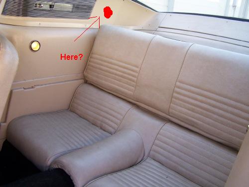

@MonsterBilly and everybody else: I hope you can see these pictures
:1967 Ford Mustang
