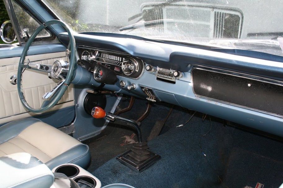

Hey Kalli, Just wondered if you had any pictures of your conversion or where the shifter now sits in the car? Also was your car a manual before or auto? I'm wondering about the clutch setup is all. Also how do you like your brakes?

sits perfectly normal. I just had to cut an extra inch of the right hand side of the shifter hole.
I used a 1966 bellhousing (6bolt-pattern, should be the same for you) and between the bellhousing and the T5 there's an adapter plate which allows mounting, adjusts the length of input shaft and actually turns the T5 a bit so it's more or less flush in the shifter hole ... you can get the adapter plate wherever they offer parts for the T5 swap (i got all that stuff from NPDlink)
