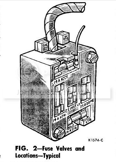

Wiring diagram for the coutesey lights and dome light
http://hammar.dyndns.org/~djhamma/wi...6/66inter1.jpg
I would bet the 7.5 amp dome light fuse is blown. Here is the location:
