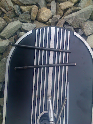

lucky lucky me ... a broken pushrod and a bent pushrod
as said it sounded like when you remove a spark plug from running engine.
the exhaust pushrod for #5 cylinder broke. since the exhaust valve couldn't open anymore the gasses went out back through the carb.
the insurance company towed the car back to buddies place. removed the rocker cover and you could see it immediately since one rocker was sideways.
well i pulled the pushrod out.
to check for length I pulled the intake pushrod as well, and that one was bent.
I'm actually convinced it has always been bent. since i got the engine the first thing I did was to correct a tapping on the intake of #5. adjusted the rocker so it would stop. this was probably caused byh the pushrod being bent.
I haved replaced the two with the one from my 289. they are 2mm shorter (0.08"). engine runs great again.
i'll get a full set of correct length pushrods now. but unfortunately found somethign else.
the lobe of the #5 intake on cam is nearly gone. when running the engine with rocker covers off I saw the rockers moving, you can make out a lift at valve. not measured. but the #5 intake travels a lot less than all the others on that bank. so I'll need a new cam soon
here's the pic, i post the video once uploaded

OK, my question is, why did a hardened pushrod break? What is the underlying cause?

If you are running hydralic lifters then i would recommend replacing them. A very good possibility is that your lifter is sticking in the extended position and as the valve train heats up and expands the lifter isnt retacting as it should. This will cause the pushrod to bend and the lobe to start wearing. The pushrods are designed to be the weak point in the valve train for just this reason so they bend and save the rest of the valve train.

2+2: very good question and one that I should always consider when something breaks.
as in the picture it broke at the pressed (or screwed?) in ball. probably the weakest link in them.
jdraper: glad they bend and break, otherwise something else (more trouble) goes.
as for the wiped lobe. i think i can't hear if one engine with 8 cylinders has a lower intake lift. it's not misfiring and still isn't. the lobe is not completely gone, but if the lift at valve is .5" i'd say the intake is about half of it. I'll definetly buy a dial to measure lift at cam on the lobes ...
