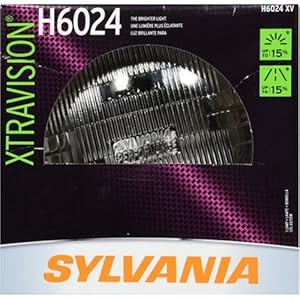

I suggest you upgrade to a head light relay setup. It will take the load off of the switch and make the lights brighter. With they relays you can run brighter bulbs.
With the relays you can run something like the Sylvania Xtravision 6024 which is what I run. They are increased wattage like most of the late model capsule bulbs. Upgrading to H4 capsule bulbs is a good way to go as well provided you use good housings.

Here is what the Silvania Xtravision looks like. Stay away from Silverstar. They have a tinting on the halogen bulb that makes them seem whiter but they won't be brighter.

I agree with tx65coupe. I run Wagner BrightLight bulbs (same as the XtraVision) and they work great. A relay setup is the next step, but I'm happy so far with the brighter bulbs.

Those Wagner bulbs are good too. I have not seen them in any stores around here, but I do know a few people that run them on their classics.
