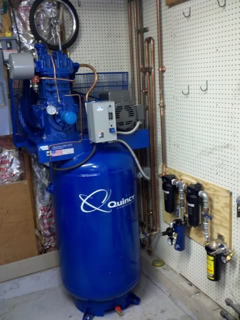

Kinda why I asked his budget. I found my Quincy on Craigslist for $650, normally a $2500 compressor. I LOVE the fact that it spins at 600rpm, its so much quieter than my craftsman. 5hp 2 stage, 17cfm at 175psi.
I consider a compressor to be part of the foundation of my tools. Took me many years of frustration with my smaller compressor to come to that realization. There are some great deals out there, even used. I agree with JMD 1000000000%, go with a commercial model. Only downside, they are heavy, my compressor weighs in at almost 700 lbs. Its also the first compressor I've owned that uses a pressurized oil system with a spin-on oil filter.

Nice setup!
I could not justify getting a large compressor because I use it so little, have no space and the garage is not wired for 220.
Now if I had my dream shop, it would be a different story!
That is a hell of a buy for $650, nice compressor. like you I thought I had bought too much compressor, but not now, a good compressor makes everything so much easier and life without the annoying "buzz" of a typical "new" compressor is simply bliss.
I made paid much, less for my compressor than all the combined price of all the previous ones I have worn out, I think it will take a long, long, time to wear this one out. There is a difference between price and value on stuff like this.
And yea it is a heavy sob..
