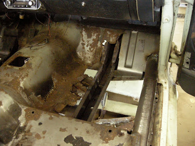

The frame rails hold the car together since there is no suspension frame. Yours are badly damaged, and in need of repair. They are welded into the floor pans. It appears that yours have torn free of the floor pans, probably due to stress from being used as a jack point. I'm not sure if thats the driver or passenger side, but cutting out the floor would reveal them, like so:
Driver side:
Passenger side:

Are you planning on doing it yourself? You'll need to know how to weld.
And I'm pretty sure you'll need and want to take the floor pan out, or at least cut out a big enough chunk. The frame right there is typically attach by welding through the floor pan, and as you can see that would work cause it's bent badly. Also, opening up a whole will give you a look into the frame rail, a good chance to treat any rust you might find.
This will probably end up being a costly repair if a shop does it, unfortunately.

Oh and by the way, unless the damage is further than the picture shows, it looks like all you need is a "Inner Floor Frame Rail". Not an entire frame rail. As opposed to $145, the inner floor frame rails are only about $30 each, so there's a chance to save money big time. Make sure that's all you need though, it'll be a waste to undershoot the problem and have to start over down the road...
As NoReins said, this could be a good chance to gain some experience on welding, grinding, etc. If you don't know how to do that at least. I didn't either, it's a cool learning process and skill to have!
