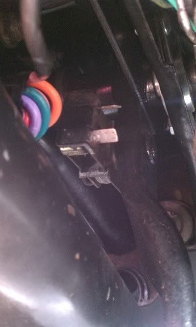

you know this got me wondering because i have a similar issue. I went under my dash to check out my brake switch and didnt see any wires attached? you see anything wrong here?

even i can see somethings wrong there

So what needs to get done here to get the brake lights to come on. Where/ what wires do I need to run and where?

your car came from factory w/ a plug that you simply plug into the brake switch.
look under dash for unused plug; may be playing hide and seek.
no plug?
look at wiring diagram for wire color code and look for loose cut wires.
proper wire disappeared?
have to run new wire per wiring diagram.

should be 2 green wires attatched to the end of the black V shaped plug.. i just dealt with this a few weeks ago.. In 67 they are green but should also be in 66...

And clean those contacts before you connect it so you get a good connection

So, I was able to find the plug hiding in the dash. I made the connection and still no lights come on when I press the brakes. What else can I check?
