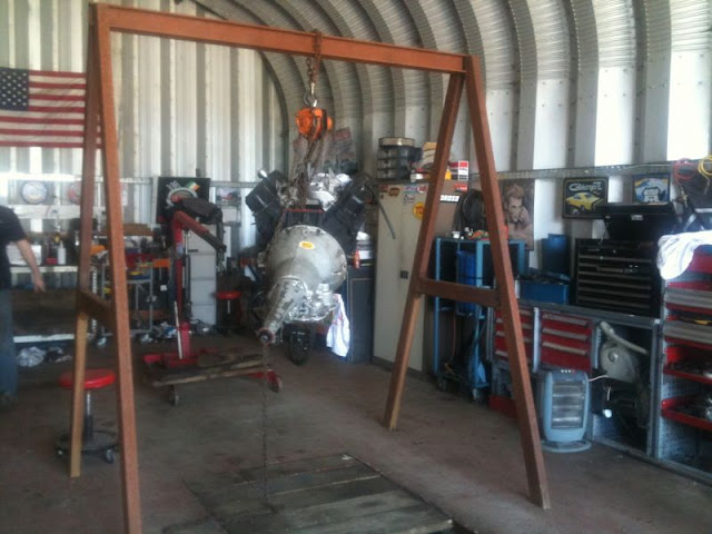

Changed the rear end ratio to 3.55, installed a new T5Z. Plan to drop the motor in this weekend. Here is what I went with...
347 short block
Pro Comp castings
machine shop assembled heads 2.02/1.60
Custom Cam 226/232@50 .540 lift on 12 lsa
Edelbrock performer rpm intake
Holley 650 double pumper carb
Still debating on whether or not to put headers on this right now. Currently I have the HIPO manifolds. I would like to see how it performs first.
Street/highway racer
